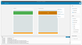

    Yes, I would expect hci_uart to work on the nRF5340PDK. There is also an overlay for it, https://github.com/nrfconnect/sdk-zephyr/tree/master/samples/bluetooth/hci_uart/boards, nrf5340pdk_nrf5340_cpuapp.overlay. Try to build it for nrf5340pdk_nrf5340_cpuapp , the file merged_domains.hex will contain both the code for the application and network core.
    merged_domains.hex
  • Hi Sigurd,
    Success! I flashed the .hex your provided and it works:
    TODO: Build firmware myself and check, whether it works.
