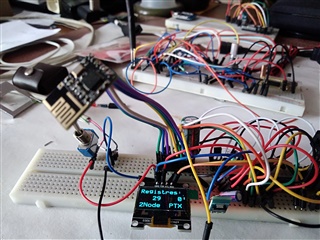

I try to establish communication between an ATmega328 based board an an Arduino Nano, so far without success. The goal is to improve a RF433 "Wire". 3 weeks ago, I started the project, but for 1 week, I do not make any progress. Please have a look to the attached pdf. Obviously I tried different settings, but probably not the right one! I spent time on internet, but didn't find how to fix.

    I think it fits well the recommandation, but nothing arrives at PRX 2Node address. I have also scoped the CE pin signal, which is in range too.

  • Yes Kenneth, arduino sketch says "radio.startListening(); // put radio in RX mode" ; "RF24 radio(7, 8); // using pin 7 for the CE pin, and pin 8 for the CSN pin" drives pin D7 high( 4.29 V). "5V pin" of Arduino is only 4.26 V and NRF24L01+ Vcc is 3.14 V coming out of an external 3.3 regulator  with 1000µF capacitor (not the 3.3 Arduino pin). I also tried that 3.3 Arduino pin which finally is better than 5V pin + external reg, but sill no data received.

    I don't really have any good suggestions for further debugging, other than possible to read out all registers on both PTX and PRX to check for any inconsistency.
    You can on the PTX simply flush the TX between attempts and clear the status bits by writing 1 to them. Make sure that the payload length here is 4 when using W_TX_PAYLOAD, since RX_PW_P0 = 0x04. I don't understand why you have set EN_RXADDR = 0x02, since that means you only enable pipe1 on the PRX, while on the PTX it will use the tx_addr/pipe0 address when using W_TX_PAYLOAD. I suggest to set EN_RXADDR = 1 or 3 on the PRX.

  • Hello Kenneth,
    I am sure my payload is 4 bytes long.
    EN_RXADDR is set by Arduino sketch:
    radio.openReadingPipe(1, address[!radioNumber]); // using pipe 1
    I do not understand your remark about TX_ADDR. My code sets reg 0x10 to 0xE7E7E7E7E7 (default value) when on the PRX side (Arduino) this address is allocated to Pipe 1 when Pipe0 is 0xC2C2C2C2C2:
    RX_ADDR_P0-1 = 0xc2c2c2c2c2 0xe7e7e7e7e7
    so EN_RXADDR = 2 should fit. Am I right ? Anyway I forced Arduino to allow pipes 0 to 3 to receive, but still no luck.
    I monitor all registers value on the PTX side :
    Reg 0 = 0b00001000 Reg 1 = 0b00111111 Reg 2 = 0b00000011 Reg 3 = 0b00000011 Reg4 = 0b00000011 Reg 5 = 0b00000010 Reg 6 = 0b00001111 Reg 7 = 0b00001110 / 0b00001111 Reg 8 = 0 Reg 9 = 0 Reg 0x0A = 0xE7..... Reg 0x0B = 0xC2.... Reg 0x0C = 0xC3 Reg 0x0D = 0xC4 Reg 0x0E = 0xC5 Reg 0x0F = 0xC6 Reg 0x10 = 0xE7... Reg 0x11 to Reg 0x16 = 0 Reg 0x17 = 0b00000001 / 0b00010001 Reg 0x1C = 0 Reg 0x1D = 0

  • Hi Kenneth,
    today I bring you some good news, finally it works! Since the early days, my code is OK, BUT I discovered by chance that my AVR board needs a cold restart (switch off wait 5sec switch on again) instead of the reset at the end of programming with AVRDUDESS. So far I don't understand why, but I will investigate deeper. May be the 1000µF capa keeps some registers in a wrong status ?
