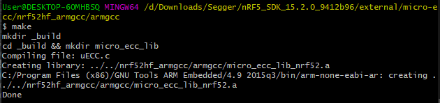

    Could you run make under nRF5_SDK_15.2.0\external\micro-ecc\nrf52hf_armgcc\armgcc and then build the porject again?
    Please let me know this can work or not. Thanks.

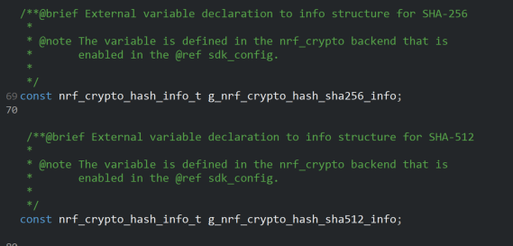

  • Update. I was able to go into nrf_crypto_hash.h and delete the replace extern const to just const so now the variables look like this:
    I read somewhere that since I am compiling this in C, they are already set to be external thus why I deleted the extern parts. However, I am now confused since the code was able to compile but Segger says that the build failed? I do not know what this means. Can you please explain?

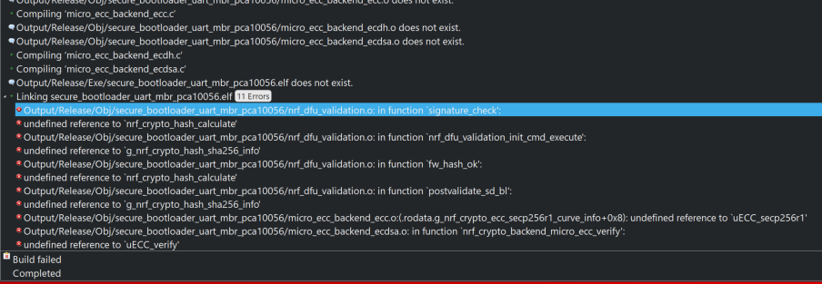

    Please select "output" in the output window and provide the log which presents more information.
    -Amanda H.
  • Here is the output given:

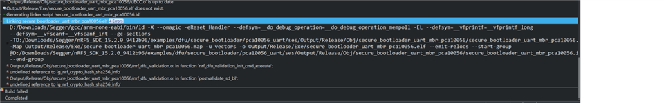

    1> Output/Release/Exe/secure_bootloader_uart_mbr_pca10056.elf does not exist.
    1> Linking secure_bootloader_uart_mbr_pca10056.elf
    1> D:/Downloads/Segger/gcc/arm-none-eabi/bin/ld -X --omagic -eReset_Handler --defsym=__do_debug_operation=__do_debug_operation_mempoll -EL --defsym=__vfprintf=__vfprintf_long --defsym=__vfscanf=__vfscanf_int --gc-sections -TD:/Downloads/Segger/nRF5_SDK_15.2.0_9412b96/examples/dfu/secure_bootloader/pca10056_uart/ses/Output/Release/Obj/secure_bootloader_uart_mbr_pca10056/secure_bootloader_uart_mbr_pca10056.ld -Map Output/Release/Exe/secure_bootloader_uart_mbr_pca10056.map -u_vectors -o Output/Release/Exe/secure_bootloader_uart_mbr_pca10056.elf --emit-relocs --start-group @D:/Downloads/Segger/nRF5_SDK_15.2.0_9412b96/examples/dfu/secure_bootloader/pca10056_uart/ses/Output/Release/Obj/secure_bootloader_uart_mbr_pca10056/secure_bootloader_uart_mbr_pca10056.ind --end-group
    1> D:/Downloads/Segger/gcc/arm-none-eabi/bin/ld: Output/Release/Obj/secure_bootloader_uart_mbr_pca10056/nrf_dfu_req_handler.o:D:\Downloads\Segger\nRF5_SDK_15.2.0_9412b96\examples\dfu\secure_bootloader\pca10056_uart\ses/../../../../../components/libraries/crypto/nrf_crypto_hash.h:78: multiple definition of `g_nrf_crypto_hash_sha512_info'; Output/Release/Obj/secure_bootloader_uart_mbr_pca10056/nrf_crypto_hash.o:D:\Downloads\Segger\nRF5_SDK_15.2.0_9412b96\components\libraries\crypto/nrf_crypto_hash.h:78: first defined here
    1> D:/Downloads/Segger/gcc/arm-none-eabi/bin/ld: Output/Release/Obj/secure_bootloader_uart_mbr_pca10056/nrf_dfu_req_handler.o:D:\Downloads\Segger\nRF5_SDK_15.2.0_9412b96\examples\dfu\secure_bootloader\pca10056_uart\ses/../../../../../components/libraries/crypto/nrf_crypto_hash.h:69: multiple definition of `g_nrf_crypto_hash_sha256_info'; Output/Release/Obj/secure_bootloader_uart_mbr_pca10056/nrf_crypto_hash.o:D:\Downloads\Segger\nRF5_SDK_15.2.0_9412b96\components\libraries\crypto/nrf_crypto_hash.h:69: first defined here
    1> D:/Downloads/Segger/gcc/arm-none-eabi/bin/ld: Output/Release/Obj/secure_bootloader_uart_mbr_pca10056/nrf_dfu_validation.o:D:\Downloads\Segger\nRF5_SDK_15.2.0_9412b96\examples\dfu\secure_bootloader\pca10056_uart\ses/../../../../../components/libraries/crypto/nrf_crypto_hash.h:78: multiple definition of `g_nrf_crypto_hash_sha512_info'; Output/Release/Obj/secure_bootloader_uart_mbr_pca10056/nrf_crypto_hash.o:D:\Downloads\Segger\nRF5_SDK_15.2.0_9412b96\components\libraries\crypto/nrf_crypto_hash.h:78: first defined here
    1> D:/Downloads/Segger/gcc/arm-none-eabi/bin/ld: Output/Release/Obj/secure_bootloader_uart_mbr_pca10056/nrf_dfu_validation.o:D:\Downloads\Segger\nRF5_SDK_15.2.0_9412b96\examples\dfu\secure_bootloader\pca10056_uart\ses/../../../../../components/libraries/crypto/nrf_crypto_hash.h:69: multiple definition of `g_nrf_crypto_hash_sha256_info'; Output/Release/Obj/secure_bootloader_uart_mbr_pca10056/nrf_crypto_hash.o:D:\Downloads\Segger\nRF5_SDK_15.2.0_9412b96\components\libraries\crypto/nrf_crypto_hash.h:69: first defined here
    1> D:/Downloads/Segger/gcc/arm-none-eabi/bin/ld: Output/Release/Obj/secure_bootloader_uart_mbr_pca10056/nrf_dfu_ver_validation.o:D:\Downloads\Segger\nRF5_SDK_15.2.0_9412b96\examples\dfu\secure_bootloader\pca10056_uart\ses/../../../../../components/libraries/crypto/nrf_crypto_hash.h:78: multiple definition of `g_nrf_crypto_hash_sha512_info'; Output/Release/Obj/secure_bootloader_uart_mbr_pca10056/nrf_crypto_hash.o:D:\Downloads\Segger\nRF5_SDK_15.2.0_9412b96\components\libraries\crypto/nrf_crypto_hash.h:78: first defined here
    1> D:/Downloads/Segger/gcc/arm-none-eabi/bin/ld: Output/Release/Obj/secure_bootloader_uart_mbr_pca10056/nrf_dfu_ver_validation.o:D:\Downloads\Segger\nRF5_SDK_15.2.0_9412b96\examples\dfu\secure_bootloader\pca10056_uart\ses/../../../../../components/libraries/crypto/nrf_crypto_hash.h:69: multiple definition of `g_nrf_crypto_hash_sha256_info'; Output/Release/Obj/secure_bootloader_uart_mbr_pca10056/nrf_crypto_hash.o:D:\Downloads\Segger\nRF5_SDK_15.2.0_9412b96\components\libraries\crypto/nrf_crypto_hash.h:69: first defined here
    Build failed
    As the error message indicates that there are multiple definitions of `g_nrf_crypto_hash_sha512_info' and `g_nrf_crypto_hash_sha256_info' and they are first defined in nrf_crypto_hash.h. You can use Ctrl+shift+F to search the variables that are also showed in which file.
    If you use the unmofidied secure_bootloader_uart_mbr_pca10056 example, I think you should remove the definition of `g_nrf_crypto_hash_sha512_info' and `g_nrf_crypto_hash_sha256_info' in the nrf_crypto_hash.h. The g_nrf_crypto_hash_sha256_info is supposed to be defined in cc310_bl_backend_hash.c as the NRF_CRYPTO_BACKEND_CC310_BL_ENABLED and NRF_CRYPTO_ENABLED are enabled in the sdk_config.h. Also check the head file (cc310_bl_backend_hash.h) is Included.
