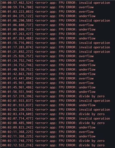

Dear Nordic,
I am running into an interesting side effect when I disable the app scheduler library from my program. I have been previously using the app scheduler to service all of my app timers, but I am now trying to reduce my dependency on this library in favor of traditional interrupts. I have an app_timer that samples an accelerometer at 500Hz and it works great as it is currently (with the scheduler) but when I disable the app scheduler I get a flood of FPU exceptions. There is a floating point operation that occurs in the interrupt but it is a single float multiplication. Below are the relevant functions and data structures involved in the interrupt. I have implemented a FPU exception handler interrupt according to the SDK example and log each error case.
I have done a couple of experiments that unfortunately did not help me understand the issue any better:
  • wrapping the interrupt in a critical section did not help
  • adding a flag to check if the interrupt was somehow interrupting itself showed that this is not the case. Similarly reducing speed of the interrupt did not solve the problem.
  • simply removing the multiplication caused this issue to go away so I am pretty sure this interrupt is the problem
