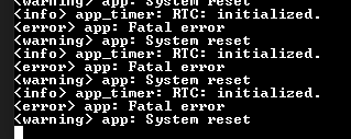

timestamp integration problem
i am trying to send temperature data along with timestamp as a string over BLE to a smartphone. i did the temperature reading part and now want to add timestamps to the reading. I am trying to integrate the nrf_calander example with my code but I am getting the following errror

static void notification_timeout_handler(void * p_context)
    UNUSED_PARAMETER(p_context);
    ret_code_t err_code;
		uint16_t length = 20;
		sprintf((char *)m_custom_value, "%s",nrf_cal_get_time_string(true));
		err_code = ble_tlog_custom_value_update(&m_tlog, &length, m_custom_value);

if I comment-out lines 797-805 the program works as it should work.
please help me with the same.

  • I have solved the issue .
    In the calendar example ,
    they are starting the LFCLK manually as below ,
    NRF_CLOCK->EVENTS_LFCLKSTARTED = 0;
    NRF_CLOCK->TASKS_LFCLKSTART = 1;
    while(NRF_CLOCK->EVENTS_LFCLKSTARTED == 0);
    and I have ported this  code in ble_blinky where softdevice starts the LFCLK by it's own .
    So , we need to remove these lines of codes from two places , one from above and the other one from ,
    nrf_cal_init() function and make sure the calendar works on RTC2 , since app_timer uses RTC1 and softdevice  takes RTC0 .
    In this way we can able to run all three RTCs .
