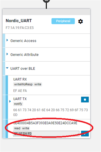

Hello All,
I am implementing a simple UART bridge over BLE and want to add a Characteristic to update the baud rate being used. I thought I added code to support a new characteristic everywhere it needs to go, but when I scan for characteristics with the nRF connect app or another BLE scanner, it does not show up in the list.  The plan is to look for the newly defined BLE_NUS_EVT_BAUD event in the nus_data_handler and update the baud rate accordingly. Is there anything I am missing here when it comes to adding a characteristic?

  • I tried this code but my p_ble_nus_evt does have not a member named p_data. I can use (uint32_t)*p_evt->params.rx_data.p_data, but this doesnt seem to be getting the entire int 32 I set. I can see I'm getting a 2 digit hex value, and it is the proper last 2 digits of what im trying to set there but not the whole number. For example, when i set baud to 9600 this value is 0x80, while it should be 0x2580.

  • I figured out this issue. p_data is only a uint8_t. Have to combine all 4 bytes to get the baud rate.
