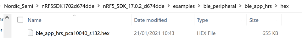

I am using the Hrs example in SDK 17.0.2 as the basis for an application.
Using an unmodified code by loading the supplied hex file ble_app_hrs_pca10040_s132.hex loaded into an nRF52 DK board I notice a few things...

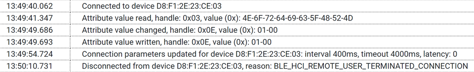

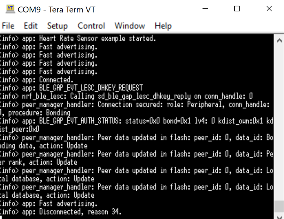

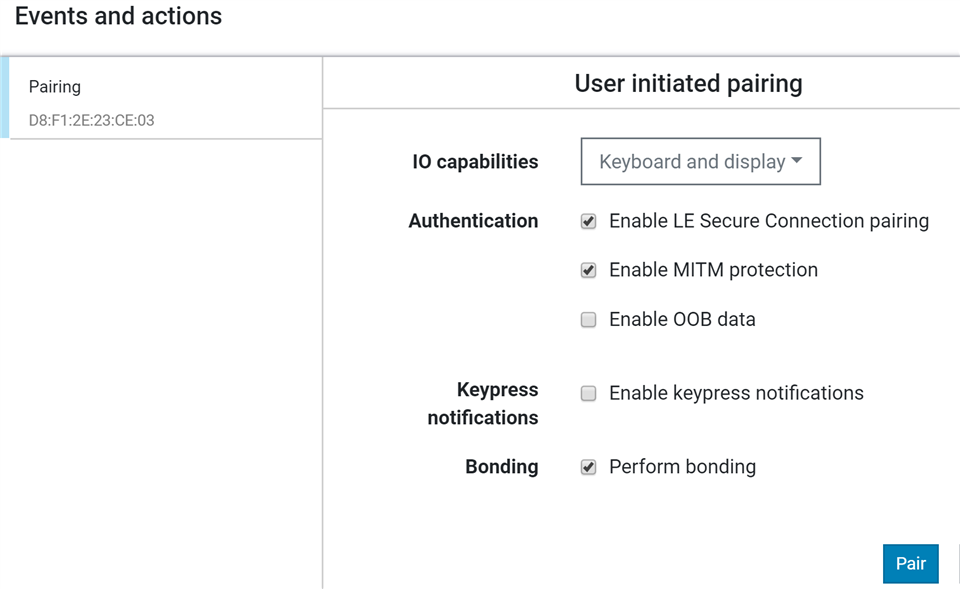

and use nRF Desktop I am not able to observe the same behaviour. I can connect via nRF Desktop & I see Advertising via the Sniffer ok. I follow the notes to initiate pairing and that looks good but if I press "Play" to try and get data from the peripheral nothing happens, meaning I don't see a regular transmission from the Slave/peripheral and eventually there is a disconnection by the Slave.

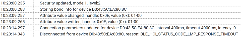

Whilst following the sequence in the notes I get this report from nRFdesktop.

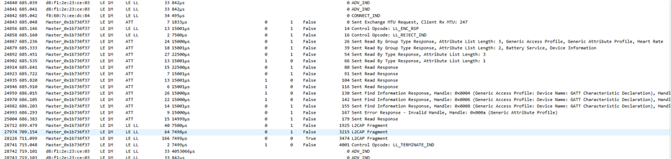

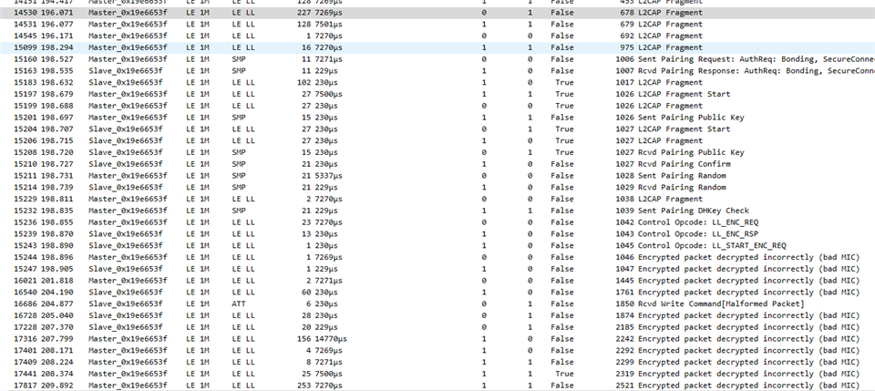

After connection but before the Disconnection I get this Sniffer trace which shows the pairing appears completed ok but thereafter I don't see anything coming back from the peripheral/slave.

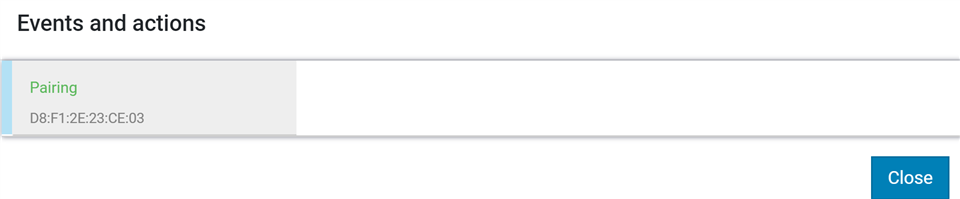

In nRF Desktop I get a green text indicating Pairing ok?

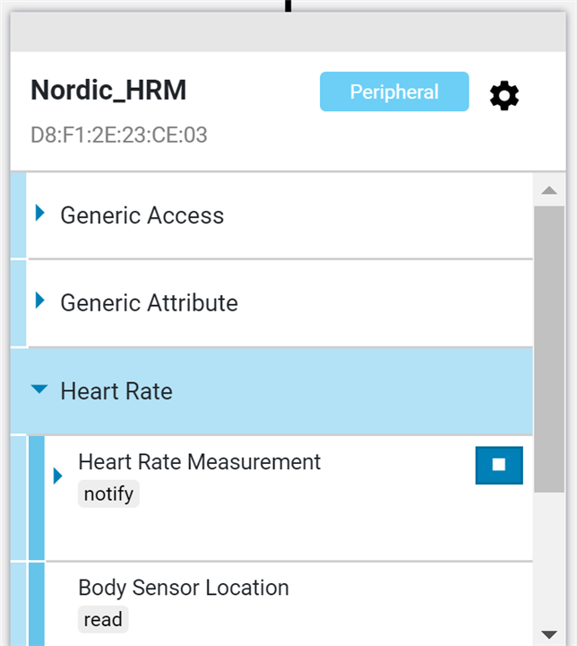

This is the "Play/Stop" button in nRF Desktop I am using...
So I think I am following the test notes ok but maybe I'm doing something wrong or there is some more detail?

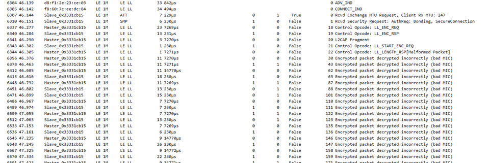

If I retry a connection but without pairing again I get...
So the link appears to use encryption ok but the result is the same meaning there is no Peripheral/slave regular transmission of (heart rate or other) data and after some timeout...
If I clear the bonding info by resetting on the nRF52 DK and go through the same procedure but without pairing I get the same result, meaning no regular transmission of heart rate etc from the Peripheral/slave.
This is the Sniffer trace in the above case.....
I have followed the pairing settings shown in the example notes which show to enable LESC,MITM & Bonding. I did do that but also not enabling MITM and I don't see any behaviour change, I consider the Peripheral ignores the MITM setting. The same goes for the I?O capabilities. I'm not sure MITM is valid using the nRF52 DK so perhaps this setting is not valid for the notes.
