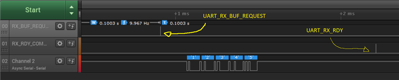

  • jongor said:
    But in practice, this isn’t the case. I haven’t “read” it anywhere, I have observed it firsthand. The Nordic driver will not raise the UART_RX_BUF_REQUEST event unless the RX has completed. It _should_ raise it as soon as the first byte is received.
    I'm not able to reproduce this. I tried to run the LPUART sample (which uses the uart_nrfx_uarte.c driver underneith) and triggered a GPIO when the RX_BUF_REQUEST event happened (here), and it did happen right before the first byte was received. I also triggered a GPIO when UART_RX_RDY happened (here and here):
    If I have misunderstood the issue, please tell me. If you could provide a sample and a step-by-step guide to reproduce the problem, that would be nice.
