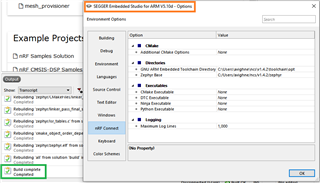

When I try to build NCS sample using SES (v5.40, also v5.30a nordic edition) it seems to build the project correctly (.elf, hex are generated)
But it throws error at the very end (screenshot attached) "Error starting process echo".
What's the significance of this and how to resolve this issue? Please advise.

  • This is what I did, that helped me build successfully (no "Error starting process echo" thrown)
    From SES (*launched via nRF Connect > Toolchain Manager > Open IDE
    open any OpenThread example solution of your choice
    Build > Clean Solution
    close SES, Toolchain Manager and nRF Connect
    copy CMakeLists.txt (attached here) from openthread Github repo shared by Torsten earlier
    to following path ...\ncs\v1.4.2\modules\lib\openthread

    #add_custom_target(print-ot-config ALL COMMAND echo -e "$<JOIN:$<TARGET_PROPERTY:ot-config,INTERFACE_COMPILE_DEFINITIONS>,\"\\n\">")
    add_custom_target(print-ot-config ALL cmake -E echo "$<JOIN:$<TARGET_PROPERTY:ot-config,INTERFACE_COMPILE_DEFINITIONS>,\"\\n\">")
    relaunch* SES
    From SES
    Project > Run CMake...
    Build > Build Solution
    That's it - no "Error starting process echo" for me now:) Hope this helps you too
