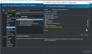

MMD error
I am adding  JLINK_MOITOR.c and JLINK_MONITOR_ISR_SES.s and add write
#if CONFIG_JLINK_MONITOR_ENABLED
NVIC_SetPriority(DebugMonitor_IRQn, _PRIO_SD_LOW);
at starting of main loop but code is not compiling some error is comming pls. see error below.
Output/ble_app_uart_c_pca10040_s132 Release/Obj/JLINK_MONITOR_ISR_SES.o: In function `DebugMon_Handler':
1> D:\NORDIC\Nordic\sdk\nRF5_SDK_16.0.0\examples\ble_central\j-link-monitoring-mode-debugging-master/JLINK_MONITOR_ISR_SES.s:159: undefined reference to `JLINK_MONITOR_OnEnter'
1> Output/ble_app_uart_c_pca10040_s132 Release/Obj/JLINK_MONITOR_ISR_SES.o: In function `_WaitForJLinkCmd':
1> D:\NORDIC\Nordic\sdk\nRF5_SDK_16.0.0\examples\ble_central\j-link-monitoring-mode-debugging-master/JLINK_MONITOR_ISR_SES.s:183: undefined reference to `JLINK_MONITOR_OnPoll'
1> Output/ble_app_uart_c_pca10040_s132 Release/Obj/JLINK_MONITOR_ISR_SES.o: In function `_HandleRestartCPU':
1> D:\NORDIC\Nordic\sdk\nRF5_SDK_16.0.0\examples\ble_central\j-link-monitoring-mode-debugging-master/JLINK_MONITOR_ISR_SES.s:228: undefined reference to `JLINK_MONITOR_OnExit'
Build failed

    Enable TIMER1_ENABLED in the sdk_config.h
    // <q> TIMER1_ENABLED - Enable TIMER1 instance
    #ifndef TIMER1_ENABLED
    #define TIMER1_ENABLED 1
