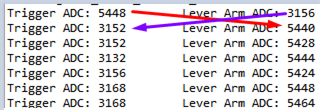

    I hope you are doing well. There is one strange thing I noticed recently while playing with ADC.
    It can happen that the ADC samples in buffer swap the position:
    As you can see above, I am sampling only two ADC channels. My configuration is similar like I found in your unofficial SAADC example:
    - There are two sampling buffers, both of size 2 (to store one ADC sample of each channel).
    In my particular use case, I am playing with ADC limits (both HIGH and LOW). This is working fine. For both ADC channels, I was able to set the limits and to get appropriate feedback through NRFX_SAADC_EVT_LIMIT in event_handler() function.
    The trouble sometimes comes when I want to read and process ADC samples. As you can see from the image above, the order of ADC samples in sampling buffer swaps only once, at the very beginning, and remains wrong for the rest of the application runtime.
    ADC sampling frequency when sample swapping occurs is equal to 1KHz. The time my application needs to read and process ADC samples is in order of 10-20us so I would not say this is an issue. The swapping occurs even when I just want to read ADC samples without any further data processing.
    When I slow down ADC sampling rate to 200Hz, let's say, the swapping of ADC samples does not happen.
    Do you have any idea what I am doing wrong?

  • Hey, Einar.
    No worries. I dug deeper today and found a solution. This thread helped a lot. An additional PPI channel is needed to trigger the START task on END event! All is good for now!

  • Hi, Einar.
    Yes, I believe the issue is resolved now as I described above.
