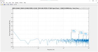

  • Also I have another Problem. I want to measure the input noise of my analog system, so I shorted the input signals. I saw that the second channel of ADC data is some how incorrect and quantized. the data from ch1 and 2 are like below:
    the code that I am using for this is:
    Are the samples somehow processed before plotted in the graphs? What does the raw SAADC samples look like?
    Have you tested with a slower sample rate, to make sure that the previous sampling is completed on both channels before starting the next? By default, the acquisition time per channel should be 10us, so unless you have not modified the drivers, you should have plenty of time for 2 channels in 50 us.
  • Yes, I convert them to voltage but the program is ok, I tested it. I reduce the SR but the problem is still there. Also my acquisition time is 10us. the interesting thing is that, when I imply an sin input to the second channel, its function is ok and I will have the correct answer.
    Another problem I have is that I have some kind of noise on my signal which includes some harmonic in 2k,4k,6k,..... I think it comes from the power switching between LDO and DCDC. Do you know how often do MCU switch between them? or what is the frequency of this task?
  • The switching between LDO and DCDC is handled automatically by the chip depending on the load: "Automatic switching between LDO and DC/DC regulator based on load to maximize efficiency"
    The DCDC switching itself happens at 8MHz, as mentioned in this post. It is possible that it could be harmonics to this, but I would need to verify that with our developers. Have you verified that the harmonics disappear if you do not enable the DCDC regulator?
