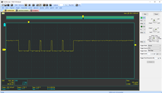

SDK17.0.2 LIBUART PROBLEM
I setted up the LIBUARTE on my custom board...
NRF52833,SDK17.0.2,With Softdevice enabled

void uart_modem_tx(unsigned char *x) // Which called every 1s....for testing
ret_code_t err_code;
// err_code = nrf_libuarte_async_tx(&modem_libuarte, x, strlen((char const *)x));
err_code = nrf_libuarte_async_tx(&modem_libuarte,"12345",5);
And what i see all the time is: (btw: i get the NRF_LIBUARTE_ASYNC_EVT_TX_DONE event)
It doesn't matter if i change to TIMER or RTC in NRF_LIBUARTE_ASYNC_DEFINE....i tried many options but the transmission is  all the time is like this.
Any idea why?
Btw: After the uarte module will work, i need to set up 2 uarte ! If you got any example of setting 2 uartse on SDK17.0.2 with app_timer it will be great !
Also , I can't run the LIBUARTE example on my custom board directly. (the RTC is LP external crystal with 32.768K)
B.r,
Yuval.
    nrf_libuarte_async_tx() takes a pointer to the data buffer, which is assigned to the UARTE peripheral to get the the data directly from RAM (through EasyDMA). Since you are passing the string directly to the function, and not through a pointer, this string will be stored in flash, where the UARTE peripheral have no way to access it. To fix this, you should declare an array first with the data, which you pass to the function:
    uint8_t uart_string[] = "12345";
    err_code = nrf_libuarte_async_tx(&libuarte,uart_string,5);
    Using two instances of libUARTE should be straightforward, just initialize and configure both instances as shown in the libUARTE example. You need to make sure to either use different resources for each instance (RTC/TIMER), or use the app_timer option.
