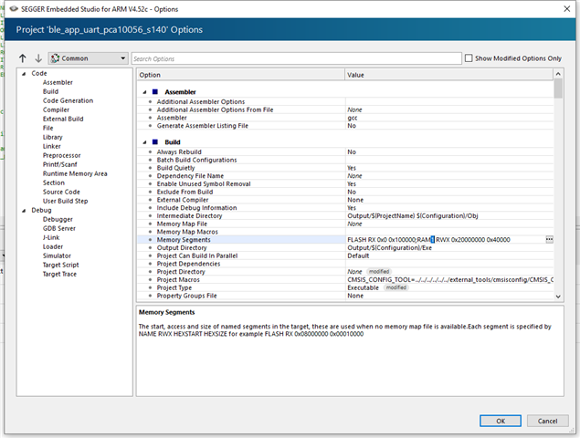

Compatibility of SES projects: Updates and fixes in the MDK used by Segger Embedded Studio break backwards compatibility with old SES project files. To use old projects in combination with this version of the SDK (MDK), make the following updates: 1. In the flash_placement.xml file: MemorySegment name must be changed from "RAM" to "RAM1": <MemorySegment name="RAM1" start="$(RAM_PH_START)" size="$(RAM_PH_SIZE)"> 2. In the .emProject file: In "linker_section_placements_segments" you must refer to "RAM1", replacing "RAM": linker_section_placements_segments="FLASH RX 0x0 0x100000;RAM1 RWX 0x20000000 0x40000"
How can I check this? kindly guide. Thanks

Muqarrab said:I have checked this and its already RAM1.
Yes, it is set to RAM1 because the project is created for SDK 17.0.2. If you plan to stick with SDK 17.0.0, you need to change this back to RAM, as this is what the toolchain expects in SDK 17.0.0.
Muqarrab said:How can I check this? kindly guide. Thanks
Same goes here, you need to change it back to RAM in the common project options:
