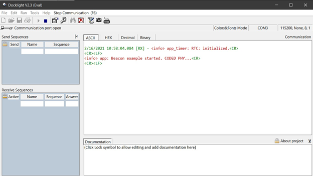

Now issue is that after doing the above steps ,when i have seen the data on serial Monitor @115200 baud rate .i was continoulsy getting "BLEBLEBLEBLE"  on Beacons Scanner / "ble_app_uart_c" output .
And Beacon Transmitter Window nothing displayed after "Beacon example started.."  startup message .

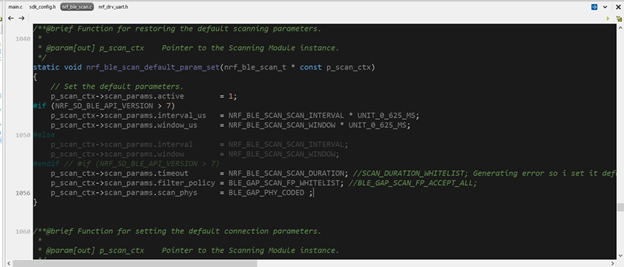

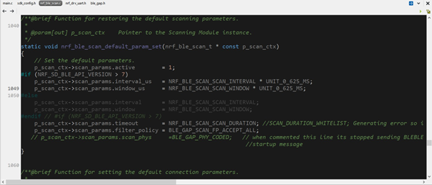

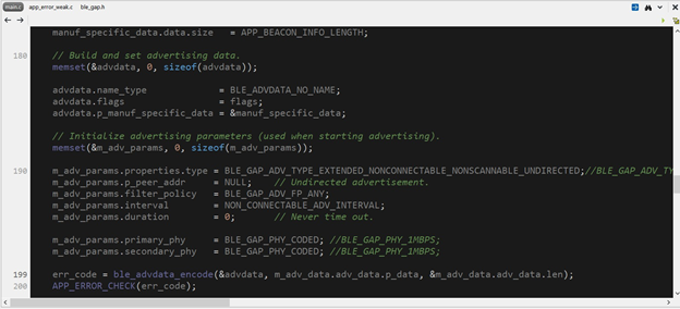

    I have made changes according to following link.
    https://devzone.nordicsemi.com/f/nordic-q-a/40365/how-to-use-ble_gap_phy_coded-in-ble_app_beacon-example/157628#157628

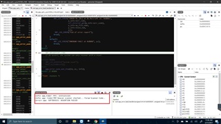

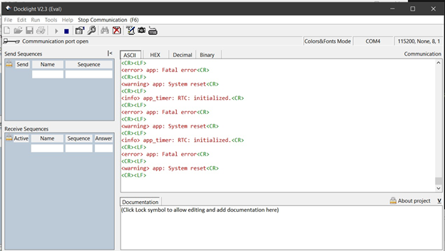

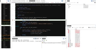

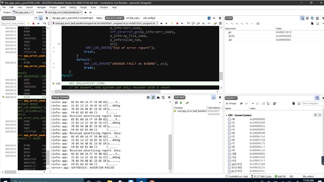

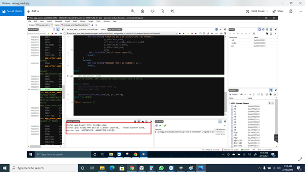

    Here is the BLE_APP_BEACON_PCA10100_S140 ,after the changes made according to the above mentioned link .
    Output on the Docklight is : system resets again and again
    ________________________________________________________________________________________

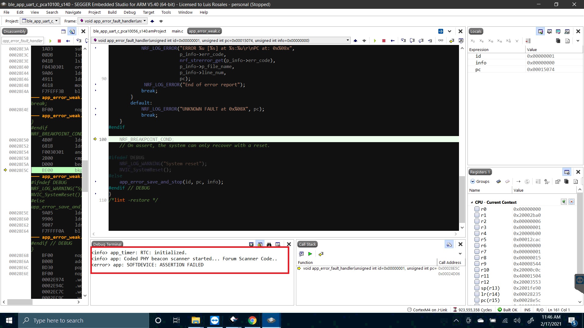

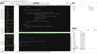

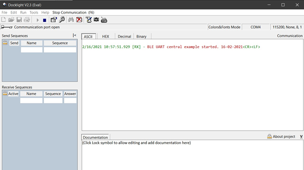

    Here is the ble_app_uart_c_pca10100_s122,after the changes made according to the above mentioned link .
    Output on the Docklight is : Sending BLE continuously

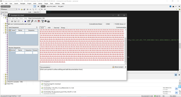

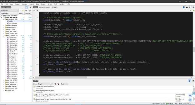

    after making 2nd changes in “ BLE_APP_BEACON_PCA10100_S140”
    Output on the Docklight is:

    Here is the ble_app_uart_c_pca10100_s122, after 2nd Change

    I have attached the "main.c" for the BLE_APP_BEACON_PCA10100_S140
    "nrf_ble_scan.c" for the  ble_app_uart_c_pca10100_s122
    i made changes to the above mentioned files only according the the link mentioned at the top
     // BLE_APP_BEACON
    #include <stdbool.h>
    #include <stdint.h>
    #include "nordic_common.h"
    #include "bsp.h"
    #include "nrf_soc.h"
    #include "nrf_sdh.h"
    #include "nrf_sdh_ble.h"
    #include "ble_advdata.h"
    #include "app_timer.h"
    #include "nrf_pwr_mgmt.h"
    #include "nrf_log.h"
    #include "nrf_log_ctrl.h"
    #define APP_BLE_CONN_CFG_TAG            1                                  /**< A tag identifying the SoftDevice BLE configuration. */
    #define NON_CONNECTABLE_ADV_INTERVAL    MSEC_TO_UNITS(100, UNIT_0_625_MS)  /**< The advertising interval for non-connectable advertisement (100 ms). This value can vary between 100ms to 10.24s). */
    #define APP_BEACON_INFO_LENGTH          0x17                               /**< Total length of information advertised by the Beacon. */
    #define APP_ADV_DATA_LENGTH             0x15                               /**< Length of manufacturer specific data in the advertisement. */
    #define APP_DEVICE_TYPE                 0x02                               /**< 0x02 refers to Beacon. */
    #define APP_MEASURED_RSSI               0xC3                               /**< The Beacon's measured RSSI at 1 meter distance in dBm. */
    #define APP_COMPANY_IDENTIFIER          0x0059                             /**< Company identifier for Nordic Semiconductor ASA. as per www.bluetooth.org. */
    #define APP_MAJOR_VALUE                 0x01, 0x02                         /**< Major value used to identify Beacons. */
    #define APP_MINOR_VALUE                 0x03, 0x04                         /**< Minor value used to identify Beacons. */
    #define APP_BEACON_UUID                 0x01, 0x12, 0x23, 0x34, \
                                            0x45, 0x56, 0x67, 0x78, \
                                            0x89, 0x9a, 0xab, 0xbc, \
                                            0xcd, 0xde, 0xef, 0xf0            /**< Proprietary UUID for Beacon. */
    #define DEAD_BEEF                       0xDEADBEEF                         /**< Value used as error code on stack dump, can be used to identify stack location on stack unwind. */
    #if defined(USE_UICR_FOR_MAJ_MIN_VALUES)
    #define MAJ_VAL_OFFSET_IN_BEACON_INFO   18                                 /**< Position of the MSB of the Major Value in m_beacon_info array. */
    #define UICR_ADDRESS                    0x10001080                         /**< Address of the UICR register used by this example. The major and minor versions to be encoded into the advertising data will be picked up from this location. */
    static ble_gap_adv_params_t m_adv_params;                                  /**< Parameters to be passed to the stack when starting advertising. */
    static uint8_t              m_adv_handle = BLE_GAP_ADV_SET_HANDLE_NOT_SET; /**< Advertising handle used to identify an advertising set. */
    static uint8_t              m_enc_advdata[BLE_GAP_ADV_SET_DATA_SIZE_MAX];  /**< Buffer for storing an encoded advertising set. */
    /**@brief Struct that contains pointers to the encoded advertising data. */
    static ble_gap_adv_data_t m_adv_data =
        .adv_data =
            .p_data = m_enc_advdata,
            .len    = BLE_GAP_ADV_SET_DATA_SIZE_MAX
        .scan_rsp_data =
            .p_data = NULL,
            .len    = 0
    static uint8_t m_beacon_info[APP_BEACON_INFO_LENGTH] =                    /**< Information advertised by the Beacon. */
        APP_DEVICE_TYPE,     // Manufacturer specific information. Specifies the device type in this
                             // implementation.
        APP_ADV_DATA_LENGTH, // Manufacturer specific information. Specifies the length of the
                             // manufacturer specific data in this implementation.
        APP_BEACON_UUID,     // 128 bit UUID value.
        APP_MAJOR_VALUE,     // Major arbitrary value that can be used to distinguish between Beacons.
        APP_MINOR_VALUE,     // Minor arbitrary value that can be used to distinguish between Beacons.
        APP_MEASURED_RSSI    // Manufacturer specific information. The Beacon's measured TX power in
                             // this implementation.
    /**@brief Callback function for asserts in the SoftDevice.
     * @param[in]   line_num   Line number of the failing ASSERT call.
     * @param[in]   file_name  File name of the failing ASSERT call.
     * @details Encodes the required advertising data and passes it to the stack.
     *          Also builds a structure to be passed to the stack when starting advertising.
        uint32_t      err_code;
        ble_advdata_t advdata;
        uint8_t       flags = BLE_GAP_ADV_FLAG_BR_EDR_NOT_SUPPORTED;
        ble_advdata_manuf_data_t manuf_specific_data;
        manuf_specific_data.company_identifier = APP_COMPANY_IDENTIFIER;
        // If USE_UICR_FOR_MAJ_MIN_VALUES is defined, the major and minor values will be read from the
        // UICR instead of using the default values. The major and minor values obtained from the UICR
        // are encoded into advertising data in big endian order (MSB First).
        // To set the UICR used by this example to a desired value, write to the address 0x10001080
        // using the nrfjprog tool. The command to be used is as follows.
        // nrfjprog --snr <Segger-chip-Serial-Number> --memwr 0x10001080 --val <your major/minor value>
        // For example, for a major value and minor value of 0xabcd and 0x0102 respectively, the
        // the following command should be used.
        // nrfjprog --snr <Segger-chip-Serial-Number> --memwr 0x10001080 --val 0xabcd0102
        uint16_t major_value = ((*(uint32_t *)UICR_ADDRESS) & 0xFFFF0000) >> 16;
        uint16_t minor_value = ((*(uint32_t *)UICR_ADDRESS) & 0x0000FFFF);
        uint8_t index = MAJ_VAL_OFFSET_IN_BEACON_INFO;
        m_beacon_info[index++] = MSB_16(major_value);
        m_beacon_info[index++] = LSB_16(major_value);
        m_beacon_info[index++] = MSB_16(minor_value);
        m_beacon_info[index++] = LSB_16(minor_value);
        manuf_specific_data.data.p_data = (uint8_t *) m_beacon_info;
        manuf_specific_data.data.size   = APP_BEACON_INFO_LENGTH;
        // Build and set advertising data.
        advdata.name_type             = BLE_ADVDATA_NO_NAME;
        advdata.flags                 = flags;
        advdata.p_manuf_specific_data = &manuf_specific_data;
        // Initialize advertising parameters (used when starting advertising).
        memset(&m_adv_params, 0, sizeof(m_adv_params));
        m_adv_params.properties.type = BLE_GAP_ADV_TYPE_EXTENDED_NONCONNECTABLE_NONSCANNABLE_UNDIRECTED;//BLE_GAP_ADV_TYPE_NONCONNECTABLE_NONSCANNABLE_UNDIRECTED;
       /* m_adv_params.p_peer_addr     = NULL;    // Undirected advertisement.
        m_adv_params.filter_policy   = BLE_GAP_ADV_FP_ANY;
        m_adv_params.interval        = NON_CONNECTABLE_ADV_INTERVAL;
        m_adv_params.duration        = 0;       // Never time out. */
        m_adv_params.primary_phy     = BLE_GAP_PHY_CODED;
        m_adv_params.secondary_phy   = BLE_GAP_PHY_CODED;
        err_code = ble_advdata_encode(&advdata, m_adv_data.adv_data.p_data, &m_adv_data.adv_data.len);
        err_code = sd_ble_gap_adv_set_configure(&m_adv_handle, &m_adv_data, &m_adv_params);
        ret_code_t err_code;
        err_code = sd_ble_gap_adv_start(m_adv_handle, APP_BLE_CONN_CFG_TAG);
        uint32_t ram_start = 0;
        // Enable BLE stack.
    /**@brief Function for initializing logging. */
    static void log_init(void)
    /**@brief Function for initializing LEDs. */
    static void leds_init(void)
        ret_code_t err_code = bsp_init(BSP_INIT_LEDS, NULL);
    /**@brief Function for initializing timers. */
    static void timers_init(void)
            nrf_pwr_mgmt_run();
     * @brief Function for application main entry.
        // Initialize.
        log_init();
        timers_init();
        leds_init();
        power_management_init();
        ble_stack_init();
        advertising_init();
        // Start execution.
        NRF_LOG_INFO("Beacon example started CODED PHY...");
        advertising_start();
        // Enter main loop.
        for (;; )
            idle_state_handle();
    // BLE_UART_C ---> nrf_ble_scan.c
    include "sdk_common.h"
    #if NRF_MODULE_ENABLED(NRF_BLE_SCAN)
    #include "sdk_config.h"
    #include <stdlib.h>
    #include "nrf_ble_scan.h"
    #include <string.h>
    #include "app_error.h"
    #include "nrf_assert.h"
    #include "sdk_macros.h"
    #define NRF_LOG_MODULE_NAME ble_scan
    NRF_LOG_MODULE_REGISTER();
    /**@brief Function for establishing the connection with a device.
     * @details Connection is established if @ref NRF_BLE_SCAN_EVT_FILTER_MATCH
     *          or @ref NRF_BLE_SCAN_EVT_WHITELIST_ADV_REPORT occurs and the module was
     *          initialized in the automatic connection mode. This function can generate an event
     *          to the main application when @ref sd_ble_gap_connect is used inside the function and it returns value
     *          that is different than @ref NRF_SUCCESS.
     * @param[in] p_scan_ctx   Pointer to the Scanning Module instance.
     * @param[in] p_adv_report Advertising data.
    static void nrf_ble_scan_connect_with_target(nrf_ble_scan_t           const * const p_scan_ctx,
                                                 ble_gap_evt_adv_report_t const * const p_adv_report)
        scan_evt_t scan_evt;
        // For readability.
        ble_gap_addr_t const        * p_addr        = &p_adv_report->peer_addr;
        ble_gap_scan_params_t const * p_scan_params = &p_scan_ctx->scan_params;
        ble_gap_conn_params_t const * p_conn_params = &p_scan_ctx->conn_params;
        uint8_t                       con_cfg_tag   = p_scan_ctx->conn_cfg_tag;
        // Return if the automatic connection is disabled.
        if (!p_scan_ctx->connect_if_match)
            return;
        // Stop scanning.
        nrf_ble_scan_stop();
        memset(&scan_evt, 0, sizeof(scan_evt));
        // Establish connection.
        err_code = sd_ble_gap_connect(p_addr,
                                      p_scan_params,
                                      p_conn_params,
                                      con_cfg_tag);
        NRF_LOG_DEBUG("Connecting");
        scan_evt.scan_evt_id                    = NRF_BLE_SCAN_EVT_CONNECTING_ERROR;
        scan_evt.params.connecting_err.err_code = err_code;
        NRF_LOG_DEBUG("Connection status: %d", err_code);

    /**@brief Function for restoring the default scanning parameters.
     * @param[out] p_scan_ctx    Pointer to the Scanning Module instance.
    static void nrf_ble_scan_default_param_set(nrf_ble_scan_t * const p_scan_ctx)
        // Set the default parameters.
        p_scan_ctx->scan_params.active        = 1;
    #if (NRF_SD_BLE_API_VERSION > 7)
        p_scan_ctx->scan_params.interval_us   = NRF_BLE_SCAN_SCAN_INTERVAL * UNIT_0_625_MS;
        p_scan_ctx->scan_params.window_us     = NRF_BLE_SCAN_SCAN_WINDOW * UNIT_0_625_MS;
    #else
        p_scan_ctx->scan_params.interval      = NRF_BLE_SCAN_SCAN_INTERVAL;
        p_scan_ctx->scan_params.window        = NRF_BLE_SCAN_SCAN_WINDOW;
    #endif // #if (NRF_SD_BLE_API_VERSION > 7)
        p_scan_ctx->scan_params.timeout       = NRF_BLE_SCAN_SCAN_DURATION;
        p_scan_ctx->scan_params.filter_policy = BLE_GAP_SCAN_FP_ACCEPT_ALL;   //BLE_GAP_SCAN_FP_WHITELIST;
        p_scan_ctx->scan_params.scan_phys     = BLE_GAP_PHY_CODED;   //BLE_GAP_PHY_1MBPS;

                scan_evt.params.timeout.src = p_timeout->src;
                p_scan_ctx->evt_handler(&scan_evt);
    /**@brief Function for stopping the scanning.
    void nrf_ble_scan_stop(void)
        // It is ok to ignore the function return value here, because this function can return NRF_SUCCESS or
        // NRF_ERROR_INVALID_STATE, when app is not in the scanning state.
        UNUSED_RETURN_VALUE(sd_ble_gap_scan_stop());
    ret_code_t nrf_ble_scan_init(nrf_ble_scan_t            * const p_scan_ctx,
                                 nrf_ble_scan_init_t const * const p_init,
                                 nrf_ble_scan_evt_handler_t        evt_handler)
        VERIFY_PARAM_NOT_NULL(p_scan_ctx);
        p_scan_ctx->evt_handler = evt_handler;
    #if (NRF_BLE_SCAN_FILTER_ENABLE == 1)
        // Disable all scanning filters.
        memset(&p_scan_ctx->scan_filters, 0, sizeof(p_scan_ctx->scan_filters));
        // If the pointer to the initialization structure exist, use it to scan the configuration.
        if (p_init != NULL)
            p_scan_ctx->connect_if_match = p_init->connect_if_match;
            p_scan_ctx->conn_cfg_tag     = p_init->conn_cfg_tag;
            if (p_init->p_scan_param != NULL)
                p_scan_ctx->scan_params = *p_init->p_scan_param;
            else
                // Use the default static configuration.
                nrf_ble_scan_default_param_set(p_scan_ctx);
            if (p_init->p_conn_param != NULL)
                p_scan_ctx->conn_params = *p_init->p_conn_param;
            else
                nrf_ble_scan_default_conn_param_set(p_scan_ctx);
        // If pointer is NULL, use the static default configuration.
        else
            p_scan_ctx->connect_if_match = false;
        // Assign a buffer where the advertising reports are to be stored by the SoftDevice.
        p_scan_ctx->scan_buffer.p_data = p_scan_ctx->scan_buffer_data;
        p_scan_ctx->scan_buffer.len    = NRF_BLE_SCAN_BUFFER;
        return NRF_SUCCESS;
    ret_code_t nrf_ble_scan_start(nrf_ble_scan_t const * const p_scan_ctx)
        // If the whitelist is used and the event handler is not NULL, send the whitelist request to the main application.
        if (is_whitelist_used(p_scan_ctx))
            if (p_scan_ctx->evt_handler != NULL)
                scan_evt.scan_evt_id = NRF_BLE_SCAN_EVT_WHITELIST_REQUEST;
        // Start the scanning.
        err_code = sd_ble_gap_scan_start(&p_scan_ctx->scan_params, &p_scan_ctx->scan_buffer);
        // It is okay to ignore this error, because the scan stopped earlier.
        if ((err_code != NRF_ERROR_INVALID_STATE) && (err_code != NRF_SUCCESS))
            NRF_LOG_ERROR("sd_ble_gap_scan_start returned 0x%x", err_code);
            return (err_code);
        NRF_LOG_DEBUG("Scanning");
        return NRF_SUCCESS;
    ret_code_t nrf_ble_scan_params_set(nrf_ble_scan_t              * const p_scan_ctx,
                                       ble_gap_scan_params_t const * const p_scan_param)
        if (p_scan_param != NULL)
            // Assign new scanning parameters.
            p_scan_ctx->scan_params = *p_scan_param;
        else
            // If NULL, use the default static configuration.
        NRF_LOG_DEBUG("Scanning parameters have been changed successfully");
        return NRF_SUCCESS;
    /**@brief Function for calling the BLE_GAP_EVT_CONNECTED event.
     * @param[in] p_gap_evt   GAP event structure.
    static void nrf_ble_scan_on_connected_evt(nrf_ble_scan_t const * const p_scan_ctx,
                                              ble_gap_evt_t  const * const p_gap_evt)
        scan_evt.scan_evt_id                  = NRF_BLE_SCAN_EVT_CONNECTED;
        scan_evt.params.connected.p_connected = &p_gap_evt->params.connected;
        scan_evt.params.connected.conn_handle = p_gap_evt->conn_handle;
        scan_evt.p_scan_params                = &p_scan_ctx->scan_params;
    ret_code_t nrf_ble_scan_copy_addr_to_sd_gap_addr(ble_gap_addr_t * p_gap_addr,
                                                     const uint8_t    addr[BLE_GAP_ADDR_LEN])
        uint16_t addr_type;
        addr_type = nrf_ble_scan_address_type_decode(addr);
        if (addr_type == BLE_ERROR_GAP_INVALID_BLE_ADDR)
            return BLE_ERROR_GAP_INVALID_BLE_ADDR;
        p_gap_addr->addr_type = addr_type;
        for (uint8_t i = 0; i < BLE_GAP_ADDR_LEN; ++i)
            p_gap_addr->addr[i] = addr[BLE_GAP_ADDR_LEN - (i + 1)];
        return NRF_SUCCESS;
    void nrf_ble_scan_on_ble_evt(ble_evt_t const * p_ble_evt, void * p_contex)
        nrf_ble_scan_t                 * p_scan_data  = (nrf_ble_scan_t *)p_contex;
        ble_gap_evt_adv_report_t const * p_adv_report = &p_ble_evt->evt.gap_evt.params.adv_report;
        ble_gap_evt_t const            * p_gap_evt    = &p_ble_evt->evt.gap_evt;
            case BLE_GAP_EVT_ADV_REPORT:
                nrf_ble_scan_on_adv_report(p_scan_data, p_adv_report);
            case BLE_GAP_EVT_TIMEOUT:
                nrf_ble_scan_on_timeout(p_scan_data, p_gap_evt);
            case BLE_GAP_EVT_CONNECTED:
                nrf_ble_scan_on_connected_evt(p_scan_data, p_gap_evt);
            default:
    #endif // NRF_BLE_SCAN_ENABLED

  • Hi Einar Thorsrud !
     Thank You !
     i run the debugger . My findings are the following .
     When Program counter goes to  NRF_LOG_ERROR("SOFTDEVICE: ASSERTION FAILED");
      PC(r15) = 0x00028d88
      pc= 0x0015074
     i  attached the image of above results as well .
    After that program stuck at the following
    NRF_BREAKPOINT_COND;
      PC(r15) = 0x00028e5c
      pc= 0x0015074
    Thanks again for your prompt response !
    Best Regards
    Muhammad Usman
  • Hi Einar Thorsurd !
    Thank for your help ! i believe problem is solved !
    followed the following link
    https://devzone.nordicsemi.com/f/nordic-q-a/51708/softdevice-assertion-failed
    and replaced the soft device files S140 SDK 17.2.0 to the components folder as directed by the above link.
    After that i got the beacon messages as shown in the image .
    Again Thank you so much for the nice support!
    Thanks & Best Regards
    Muhammad Usman
