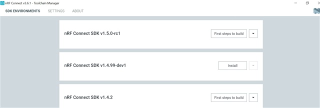

I am having some issues with my SDK configuration. First of all, I am using nRF Connect for Desktop on a Win10 machine. There I installed the Toolchain Manager in order to develop with the SDK. Next I selected to install v1.5.0-rc1 and when starting SEGGER Embedded Studio from SDK directory I get "Zephyr base not set". I have checked the section on how to install the SDK manually but I'm not sure what the message "Zephyr base not set" means. What am I missing and how do I fix it?
  • Running nRF Connect as administrator did not solve the issue. I also tried to install another version of the SDK without any improvements, Open IDE not present.
  • Normally, it should not be necessary to install the SDK as administrator.

    Obviously, the repositories have not been downloaded to your computer. Probably they have been blocked. If there are no active VPN connections, the anti-virus program might be the reason. Could you perform a re-installation with your anti-virus deactivated?
  • Thanks for the log! Ok, I will try to do a re-installation of the SDK with my anti-virus deactivated.
  • Deactivating the anti-virus on a corporate machine is not always easy, I cannot do that myself so support from IT department is awaiting.
    In the meantime I am looking at the possibilities to get what I need without setting up the full toolchain. If I understand it correctly, there are precompiled examples in the SDK that can be used for testing. I have tried the blinking LEDs (drag and drop to my DevKit drive) and it worked fine. Now, is it expected that the examples for BLE peripheral works the same way? It should work to just drag and drop "ble_app_beacon_pca10040_s132.hex" to my DevKit drive?
  • Yes, the examples for BLE peripheral work the same way. Since "ble_app_beacon_pca10040_s132.hex" isn’t part of the NCS, I assume that you are currently using the nRF5 SDK?
