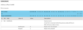

    You may check the 0x480 (ERRORSRC) in your handle function. Maybe it's the overrun issue (TX signal issue) in this case.

    Yes, it's a overrun issue but why? I can see all the data in oscilloscope, I'm using FTDI cable to send data, everything is there, valid. FIFO size is 256 bytes for both Rx and Tx.

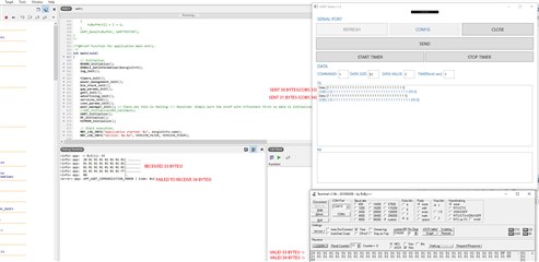

  • Okay, first I've checked the hardware, for the 10th time, could not found errors.
    Then I compiled and run ble_app_uart, getting the same results!
    Then I went ballistic...Placed logging all over the place and eventually I figured all data are received, only NRF_LOG_HEXDUMP was printing first 80 bytes!
    Changed NRF_LOG_MSGPOOL_ELEMENT_COUNT from 8 to 64 and everything prints! I can receive up to 256 bytes with no problems at baudrates of 115200 and 250000. Bloody hell...
    After that it was time to see why UART gave comm errors (overrun) at 576k baudrate, so I connected oscilloscope and another FTDI to se what I am transmitting and receiving. Transmitted data is valid, so is the received data. But, nRF does not receive more than 33 bytes at 576k.
    Not sure if image will be visible correctly but I always get overrun error on UART if I send more than 33 bytes.
