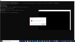

  • Hi Vidar,
    CONFIG_BT_DEVICE_NAME was set to "NCS DUT" in prj.conf
    I changed it to "BT_NUS_Shell" and rebuilt the sample and retried 'Testing using shell_bt_nus'. Yet the test script threw the same "Target device not found" error. When checked with 'nRF Connect for Mobile' app, found that the device still advertised with device name "NCS DUT". The updated CONFIG_BT_DEV_NAME in 'prj.conf' doesn't seem to override the default device name. Hence updated (reconfigured) the same in subsys/bluetooth/host/Kconfig.
    I successfully tested the newly built sample!
    Thank you very much!
