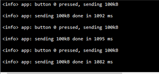

    I also attached here a small example that you can test. It's a modified version of ble_app_uart that send 100kB of data (500 packets of 200bytes each). At 7.5ms I can see the throughput of around 100kB/s when the phone is close.
    You can test by connect using the nRFToolbox app =>Uart Profile to connect, and then click button 0 on the nRF52DK. Or you can use NRF Connect, and enable CCCD before testing.
    The fundamental difference I can observe here is that the MD bit at the end of the connection event is set on the last packet from the slave, meaning the slave can send more data but the central didn't want to receive more.
    When in your case the slave didn't want to send more data. The example is from SDK v17.0.2 and for nRF52832 DK. Please use RTT logging when testing.

    I finally found the DK in our office and managed to run some tests. I did three runs with the following settings:
    1. Your sample unmodified (I did have to give Softdevice 256 bytes more RAM)
    2. sample with conn_interval min & max set to 45ms (to match what our settings default to when connecting to Android)
    3. Conn interval of 45ms and DLE set to match ours (165)
    In all cases the transfer speed was high and the packets are transferred over most of the connection interval.
    I'm really running out of ideas on what could cause our weird behavior. Also a curious detail: in the 165 DLE test the DLE gets set to 165 / 165 on 3rd try or something. (initially 165 / 27 since phone wants 251 / 27).
    UART_Test_45ms.bttUART_Test_45ms_DLE165.bttUART_Test_orig.btt
