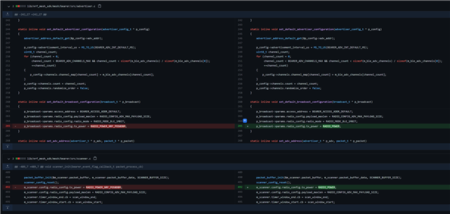

Hello there,
we get the following assert:
"00> <t:     480881>, app_error_weak.c,   98, Softdevice assert: 88996:0"
The board is rebooting constantly after 3 ... 7 minutes of work. What could be that 88996?

    It's pretty strange that changing the tx_power in mesh can cause a softdevice assert.
    I tried to test the same but I couldn't reproduce the issue. If you test on light switch example do you see the same problem ?
    Also I don't think changing the TX_POWER in scanner.c would have any effect. Could you please test with only modification in advertiser.c ?
    In addition, could you verify that if you change the TX_POWER back to 0dbm the problem will disappear ?
