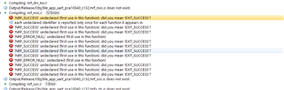

Hi simonr,
I have understood the above RTC Example, I need your help to combine that RTC sleep mode with my application code
Okay, what exactly do you need assistance with? In this case, my colleague, Jared, helps out with a similar case. Please checking that out for reference.
