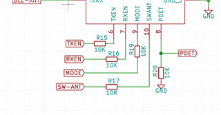

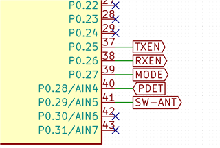

Connection between RFX2411N & nRF52832 - GPIO Usage Restriction(low frequency pins)
        I am using RFX2411N RF amplifier in my hardware design. I chose nRF52832 as an MCU. In nRF52832 datasheet, it is mentioned that the pins from P0.22 to P0.31 have some restriction(low frequency pins). So, Can I use any of these pins for the connection between RFX2411N and nRF52832?(TXEN, RXEN,MODE,SW-ANT,PDET). Image at the left (mcu nrf52832), image at the right (RFX2411N).
RFX2411N datasheet Link : www.skyworksinc.com/.../RFX2411N_204380B.pdf
