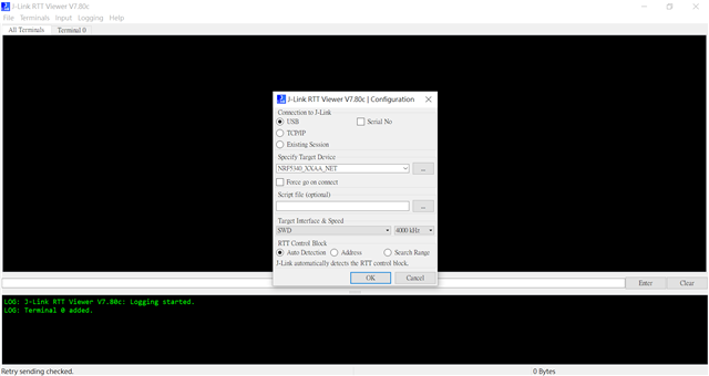

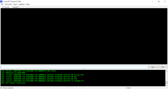

    Thanks. From what i understand this is how you merge an app project and nw project. I want to debug my nw project using SES. I have programmed the blank app application to enable the nw processor. I then load my nw application (in this case Temperature) and then run the debugger, which runs. I can watch the appropriate variables but I don't see debug output in the UART window or the debug window. If I stop the debugger and run Jlink RTT viewer with the NW core I am able to see the RTT output. So in a nutshell when I'm debugging in SES I can't see this debug output even when the debugger is running.
    Alex
