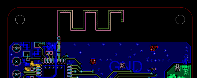

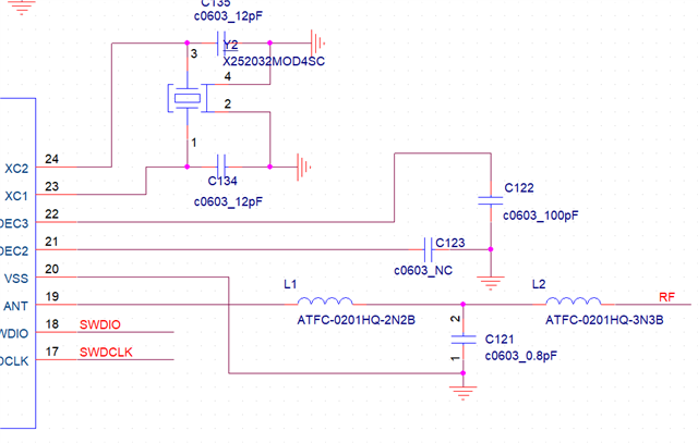

can't scan using android
I'm using nRF52810 with custom pcb antenna.
When i scan my device using nRF52 DK and nRF Connect in windows 10, my device scanned.
But, when i scan my device using android smartphone(samsung gallaxy note9, samsung gallaxy tab1, tab2, tab3), i can't see my device in scanned list.
The antenna power of my device is about -67dbm.
Is this problem of custom antenna?
I designed antenna by referring to nrf52840 dongle.
This is my second board
Thansk.
This is my first board.
It's work well.
