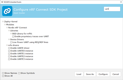

  • I edited the thingy91_nrf9160_common.dts file in ncs/v1.4.0/nrf/boards/arm/thingy91_nrf9160 as you suggested, but still got the same current. I tried to disable uart0, too, but I got errors while opening the project. In my configuration UART is disabled anyway:
    I am suspecting the cpu and clock don't go to sleep during PSM. In the Asset Tracker code I didn't discover any CPU idling calls. What do you think about adding k_cpu_idle() at the end of each work_fn function? What is the correct way to let the CPU / clock sleep during the PSM interval in the Asset Tracker code?
  • Hi, sorry for the late reply. If you are using the asset tracker application from NCS 1.4.0 there are two things needed to be done in order to get the power consumption down. You need to disable logging and disable UART1. This can be done through the application during run-time.
    Add the following to main.c:
    #include <device.h>
    #include "power/power.h"
    const struct device *console, *uart1;
    void main(void)
      // Turn off logging (which is using UART0):
      console = device_get_binding(DT_LABEL(DT_CHOSEN(zephyr_console)));
      device_set_power_state(console, DEVICE_PM_OFF_STATE, NULL, NULL);
      // Turn off UART1:
      uart1 = device_get_binding(DT_LABEL(DT_NODELABEL(uart1)));
      device_set_power_state(uart1, DEVICE_PM_OFF_STATE, NULL, NULL);
    And in prj.conf
    CONFIG_DEVICE_POWER_MANAGEMENT=y
    Now the current should drop down from 600uA.
    There's no need to remove the UI module or do any other changes to the application.
     This is automatically handled by zephyr. When the thread is finished the CPU goes to sleep. The CPU current is about 3mA, while 600uA indicates that the HF clock is running (because of UART0 RX (logging and AT commands) and UART1 RX)
