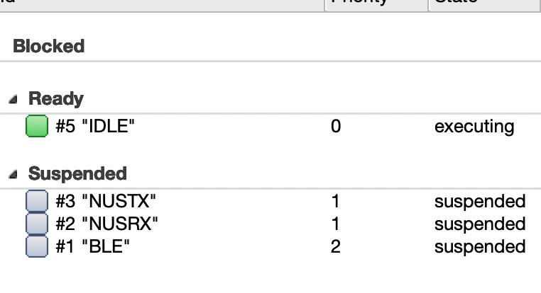

I am having an issue when a peripheral (NUS) is sending and receiving significant amounts of data over BLE I get the Soft Device locked up.
 I am running FreeRtos and can tell my tasks are alive via button presses and RTT commands.
However, when I get this  soft device ble "freeze" I get the following symptoms that seem to indicate the Soft Device is locked up:
1. I see a disconnect on the IOS side and do not get BLE_GAP_EVT_DISCONNECTED on the Nordic side.
2. BLE advertising stops when it was previously running
  • Is the Central Scan causing this?
    • If I disable scanning I do not get the freeze.
    • If I increase the SCAN_INTEVAL and reduce the SCAN_WINDOW, the freeze takes longer, but still seems to occur after a few minutes of stress testing the NUS ble comms.
      These settings also really slow down connections to my peripheral.
    • #define SCAN_INTERVAL MSEC_TO_UNITS(300, UNIT_0_625_MS)
      #define SCAN_WINDOW MSEC_TO_UNITS(10, UNIT_0_625_MS)
      #define SCAN_TIMEOUT 0x0000 //MSEC_TO_UNITS(10000, UNIT_10_MS) //0x0000 /**< Timout when scanning. 0x0000 disables timeout. */
      /** @brief Parameters used when scanning. */
      static ble_gap_scan_params_t const m_scan_params = {
          .active = 1,
          .interval = SCAN_INTERVAL, // SCAN_WINDOW * 2,
          .window = SCAN_WINDOW,
          .timeout = SCAN_TIMEOUT,
          .scan_phys = BLE_GAP_PHY_CODED | BLE_GAP_PHY_1MBPS,
          .extended = 1,
          .filter_policy = BLE_GAP_SCAN_FP_ACCEPT_ALL,
      44
  • Is there some sort of soft device call back I should be getting that should be reporting a critical error?
  • Perhaps there is a softdevice function I can check to see if I am taxing the soft device too hard or if the radio has been locked up too long?
  • Perhaps there is an issue with the BLE stack size in FreeRtos?  I tied increasing it to 256*5, but that didn't change anything.
  • Perhaps I need to change my scan interval and my advertising interval and other connection intervals to maintain all of these connections?
  • Are there any improvements in SDK 17 that would help with this condition?
I know I am really doing a lot of simultaneous connections while scanning (on by Phy speeds!) and advertising.   Any help in identifying the stack lock up and how to mitigate this with this many connections would be very helpful.  I am guessing I have to slow things down a bit.
