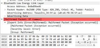

CAN I Customize my adv packet Absolutely?
I think this is a very weird requirement
Normally , I use manufacturer data to do this like picture below
it's easy and quick
but it contains len and type occupying 2 bytes
I'm wondering if there is a way to make my packet have no len and type
I know that Texas's chip can do this like picture below
it will shows malformed packet
Thanks
    Yes, and no. Type and Len is requires for each new datafield as per the BLE specification. Leaving out these two fields violated the specification, and as such the SoftDevice has checks to ensure this does not happen. If you would like to do this, you may use the Radio peripheral directly, to communicate using your own proprietary protocol. You may implement this prorprietary protocol by using timeslots to combine with using the SoftDevice. This way, the SoftDevice will release the control of the radio peripheral, so that you may do whatever you want in the time that the SoftDevice does not require the radio for BLE.
    If you want to look into implementing your own radio protocol there are many posts on the forum about this already, and I highly recommend scrolling through these to get a better understanding of what this would entail.
    Any chip with access to a 2.4 GHz radio peripheral can do this - but this is not BLE - which is why the sniffer displays the packet as malformed.
    Non-sniffer devices will discard any malformed packets, so unless you control both sides of the link this is not a possibility.

  • HI Karl
    the reason is
    My boss bought a Bluetooth Gateway system that only accept it's own protocal
    And I have to make a device to send data through by broadcast
    Actually,I have tried Srdata and Extend ADV already but the gateway didn't accept
    because of the len and type
    it only accepts packets that start with 0x24C3 like i circle in the picture below
    so i think proprietary protocol it's the only way
    or if there is an easier way to do that?
