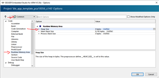

I'm looking to store a batch of data in a large array in RAM and send them all at once later. I start from ble_app_template in sdk examples and add an array. My memory setting is RAM (rwx) :  ORIGIN = 0x20002e70, LENGTH = 0xd190. In the code I'm only able to declare a float array with the size of around 8000. Higher than that there would be error of region RAM overflowed with stack when building the project.
Based on the memory setting, there should be about 53000 bytes available, but I could only use about 32000 bytes for the array. Do the other parts in ble_app_template main file use all the remaining 20000 bytes? Is there any way to squeeze more space to make the array larger?
    Yes,your calculations are correct. Assuming you use SES, that reserves 8 kB for heap. Most probably you do not use any, so you can set that to 0, saving 8 kB. See screenshot:
    I suspect you allready did this though, or use another toolchain, as this takes RAM usage down to about 21 kB.
    To reduce it further you can disable things you do not need. For instance, if you do not need logging you can set NRF_LOG_ENABLED to 0 in sdk_config.h. to reduce it by a few kB. And you can continue to gain some memory hear an there by removing code and modules you do not need.
