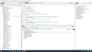

I tried to build the example project for UART serialization demo, "ble_app_hrs_pca10040_s132_uart". It failed with 3 errors, see attached image.
It is SDK 17 and SEGGER IDE 5.4.
I didn't do any modification with the example project, and I checked the project include file path. I couldn't see any problem
please help
    My guess is that the path to your project is too long. In Windows, there is a weird limitation on how long the path of files that the compiler can see.
    Try to put the SDK closer to your C-drive, so that it has a shorter path. In my case, I have the SDK located in:
    C:\Nordic\SDKs\17.0.0
    note that I also shortened the long name of the SDK to just "17.0.0".
    Let me know if that doesn't work. I see that you are using the ble_app_hrs example. Have you ran the script located in:
    SDK\external\micro-ecc\build_all.bat? I don't think the error message that you are seeing is because of the lack of that, and I believe this is actually built when unzipping the latest SDKs, but I am not completely sure.
    Edvin
  • Thanks. The problem is gone.
