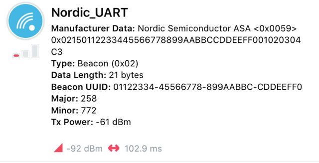

Hope doing well . I have a question regarding nrf52833 maximum power transfer @ 8dbm . I am using the "ble_beacon app" and using sdk 17.2.0 and soft device is S140.I tried many tests but results are almost the same . here are the my tests and the results.

i have placed the
uint8_t err_code = sd_ble_gap_tx_power_set(BLE_GAP_TX_POWER_ROLE_SCAN_INIT, BLE_CONN_HANDLE_INVALID, 8);
just before the infinite loop . and changed the value of transmit power from 0-->4--->8 , as mentioned below
uint8_t err_code = sd_ble_gap_tx_power_set(BLE_GAP_TX_POWER_ROLE_SCAN_INIT, BLE_CONN_HANDLE_INVALID, 0);
uint8_t err_code = sd_ble_gap_tx_power_set(BLE_GAP_TX_POWER_ROLE_SCAN_INIT, BLE_CONN_HANDLE_INVALID, 4);
and when i set the
uint8_t err_code = sd_ble_gap_tx_power_set(BLE_GAP_TX_POWER_ROLE_ADV , BLE_CONN_HANDLE_INVALID, 8);
by setting this  BLE_GAP_TX_POWER_ROLE_ADV as mentioned above . Controller Resets again and again .

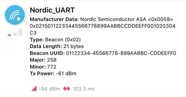

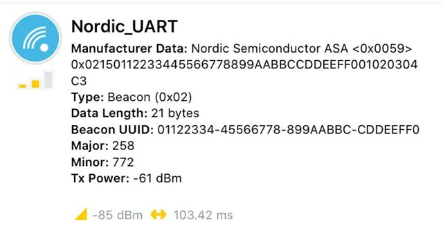

My RSSI results are as follows .
transmit 0dbm @ 3 meters distance and RSSI is -85dbm
transmit 0dbm @ 3 meters distance and RSSI is -61dbm
transmit 4dbm @ 3 meters distance and RSSI is -94dbm
transmit 8dbm @ 10 meters distance and RSSI is -92dbm
as you can see , no significant increase in the power .
thank in advance ! for the help
