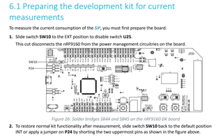

I'm not sure why there would be a difference between the two boards but this may be caused by parts of the USB circuit, the debugger circuit and/or other regulators on the board. That said, the nRF9160DK itself is not designed to be low power, and not to be measured using USB. You are measuring everything on the board, and not the nRF9160 alone. This is why you should follow the documentation I linked to yesterday and measure current draw on the nRF Current Measurement pins, which will measure current from the nRF9160.

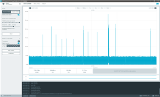

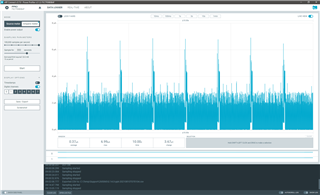

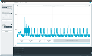

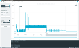

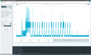

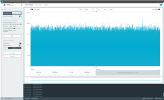

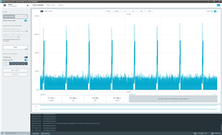

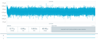

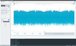

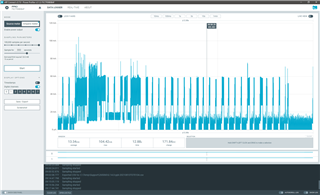

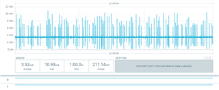

I'm finally getting back to this. I have a PPK2 to do the measurement now and ran a simple program: "k_thread_suspend(k_current_get())" as the only line and an empty prj.conf file, using NCS 1.4.1. tried it on HW 0.8.2 and 0.15.0 and see a big difference in power usage.
results with 0.8.2:
results with 0.15.0:
As you can see 0.15.0 has a higher baseline and frequent spikes. The test was powered by USB with the PPK2 GND, VIN, VOUT connected as per the directions and the profiler in ampere mode. I don't think that's the right way to measure this, so can you explain the correct setup to me?
Ultimately, I want to understand why 0.15.0 is using so much more and hopefully be able to correct it. Perhaps is there a CONFIG option I should be using with this rev?

Can you provide information on your test setup? Have you connected the DK as per instructions in our infocenter?
How is connection done on DK v0.8.2 vs DK v0.15.0?
