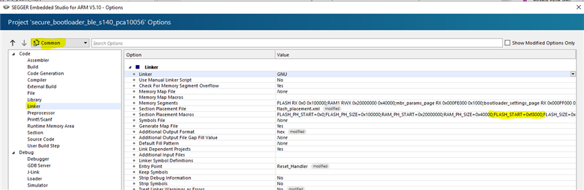

  • Hi Hung,
    I was able to do the full DFU. I added the NRF_DFU_BANK_VALID_SD_BL_APP case where it activates the application first, then the SD and then the BL.
    I generated my DFU package with a release version of my bootloader.
    When I test from release bootloader to release bootloader it works but when I try from debug bootloader to  release bootloader it fails at the bootloader section.
    Here is the debug log:

    Is the problem going from debug to release?
    Thank you,
    Ofer.
  • Hi Ofer,
    Have you checked if the start address in flash of the debug build and the release build is actually the same ?
    I would suggest to test by simply use nrfjprog to overwrite the debug bootloader with the release bootloader and check if it can run.
    If it run you may need to print out logging or use GPIOs toggle to debug.
  • Thank you Hung,
    In the Segger bootloader project, I right click the project and then in the Build->Memory Segments I get for both:
    FLASH RX 0x0 0x100000;RAM1 RWX 0x20000000 0x40000;uicr_bootloader_start_address RX 0x10001014 0x4;bootloader_settings_page RX 0x000FF000 0x1000;uicr_mbr_params_page RX 0x10001018 0x4;mbr_params_page RX 0x000FE000 0x1000
    Is it enough to say that they both start at the same place?
    All the best,
    Ofer.
  • Hi Ofer,
    The actual start address is at Section Placement Macros. For example here the bootloader starts at 0xF8000 in flash.
