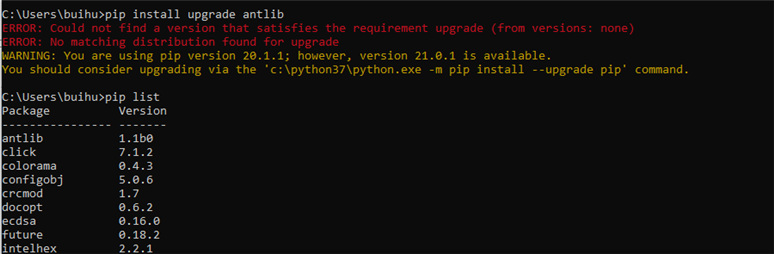

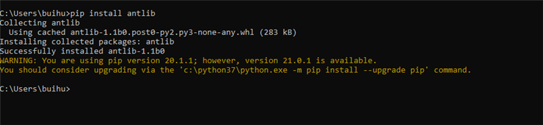

  • Hi Sanjiv,
    I would suggest to try testing with python 3.7 as well.
    Could you do "pip list" so that it would list all the version of the plugins ?
    I have this when I list my plugins:
    You can try to uninstall and install antlib again. I don't have that "warning discarding " as showed in your log,
    I would suggest to try install without the cache, after you uninstall, you use this:
    pip install antlib --no-cache-dir
    So the cache will not be used.
