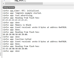

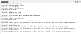

  • Hi
    Here is the output. When I call the same function before connection it saves and read data from memory BUT when I call the same function after connecting the device it not work.

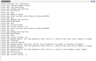

  • Hi ,
    1-These are two functions to save/read data from flash. These are okay?
    void write_in_flash(uint8_t place)
        ret_code_t rc;
        place=place*16;
        sd_flash_page_erase(0x47);
        rc = nrf_fstorage_write(&fstorage, flash_start_address+place, save_data, sizeof(save_data), NULL);
        APP_ERROR_CHECK(rc);
        wait_for_flash_ready(&fstorage);
        NRF_LOG_INFO("Done.");
    void read_in_flash(uint8_t place)
        ret_code_t rc;
        place=place*16;
        rc = nrf_fstorage_read(&fstorage, flash_start_address+place, read_data, sizeof(save_data));
        NRF_LOG_INFO("Reading from flash hex:");
        for(uint8_t i=0; i<sizeof(read_data); i++)
            NRF_LOG_RAW_INFO("%02x:", read_data[i]);
        NRF_LOG_RAW_INFO("\r\n");
        NRF_LOG_INFO("done");
    2-When I called these functions without connection it works.
    void Charcteristics_10(uint8_t test)
        NRF_LOG_INFO("Function Called");
        save_data[0]=0x55;
        save_data[1]=0x55;
        write_in_flash(2);
        read_in_flash(2);
    3-When I called the same function after connecting the device I get no response also device does not connect. (Stuck in connecting)
