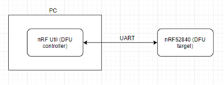

2) In a normal use case for nrfutil, we can write the command:
nrfutil dfu serial -pkg FWupdate.zip -p COM5 -b 115200
This command would normally open com port 5 and send the data through it, where on the other end, the UART DFU target would receive it, see the illustration below:
Normal use case for nRF Util
This use case, however, will not work for our product, because we need to send the data through the Internet, which is not an option with nrfutil. In theory, we could work around this by creating a dummy PC app whose task would only be to provide a virtual com port towards nrfutil, while channeling the received data further via LTE. When the nrf9160 chip receives the data via LTE, then it immediately sends it via UART to the DFU target that is the nrf52840. See the illustration below:
