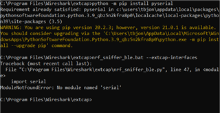

    However, when we attempted to test the Sniffer using the "nrf_sniffer_ble.bat --extcap-interfaces" we received the following error message:
     If you have not already, please try to install the pyserial package using the command below and see if that fixes the problem. Maybe the module was installed to another python installation earlier?
    $ python -m pip install pyserial

    I performed the above suggestion but still encountered the issue.

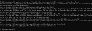

  • So I didn't see the Python folder in the Windows folder but I did paste the above command and it seemed to work there.

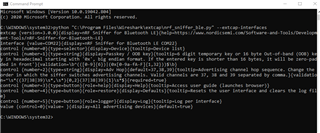

  • Thanks for checking. So it looks like the nrf_sniffer_ble.py work fine when invoked directly, but not when it is invoked via the nrf_sniffer_ble.bat batch script for some reason. The problem with this is that Wireshark needs the batch script to work in order to load the plugin. It seems to be the same issue as was described in the other post I linked to earlier.
    As a test, could you try to replace the original nrf_sniffer_ble.bat file with the one attached below? I removed all the steps that should be redundant for your setup. With this script I would expect you to get the same output from  "nrf_sniffer_ble.bat --extcap-interfaces" as you get with "C:\Program Files\Wireshark\extcap\nrf_sniffer_ble.py" --extcap-interfaces"

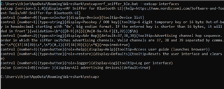

    I replaced your file with the one in the personal extcap and it does appear to work.

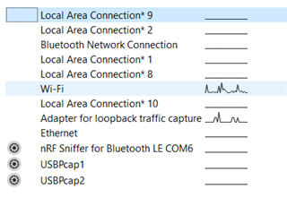

    The 52840 DK is now displayed as an interface in Wireshark but I'm not seeing any signals being detected by it.  Is that normal?  I have my phone, laptop, and Bluetooth mouse near the DK but no signals.
  • Correction.  I placed the DK in between the phone and a separate 52840 module and did detect signals.  I had assumed the DK would be detecting all BLE signals in the area.
