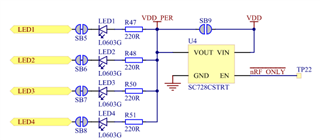

led 1 is off but p0.13 get 3v output , similarly led 1 is on p0.13 get 0v output, how to change it help me. similar for led 1 to led 4 respectively p0.13 to p0.16.

This is as expected, since the LEDs are active low. See this link:
https://infocenter.nordicsemi.com/topic/ug_nrf52840_dk/UG/dk/hw_buttons_leds.html

In nRF5 SDK for Mesh, the examples uses the simle_hal.c for this functionality. You can use the hal_led_pin_set() function to set the LED on or off.
/** * Sets the LED for the given PIN. * @param[in] pin LED pin number. * @param[in] value @c true for on, @c false for off. */ void hal_led_pin_set(uint32_t pin, bool value);
