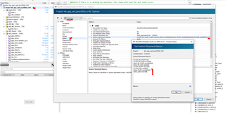

Also, I have a few questions :
1. How can I increase NRF_SDH_BLE_GATT_MAX_MTU_SIZE from 247 to 512? Because it is a 1-byte value and 512 needs 2-bytes  will need to mess with the SD libraries
2. Is it possible to increase the NRF_SDH_BLE_GAP_EVENT_LENGTH  higher than 6? Because when I set it to 7 or 8 the whole system stops.
If there is something else that I have not taken into account please correct me.
Thank you for your time
Regards
     It should be enough to just set it to 512. But, 247 will give you the max throughput. By setting NRF_SDH_BLE_GAP_DATA_LENGTH = 251 (this is max for this setting), and NRF_SDH_BLE_GATT_MAX_MTU_SIZE = 247, we avoid fragmentation of the ATT packet into several on-air data packets.
     Yes, but you would likely need to allocate more RAM to the SoftDevice. How this is done depends on what toolchain/IDE you are using.
    Also, as long as the phone does not limit the amount of BLE packets per connection interval, you might be able to get slightly higher throughput with a higher connection interval.
    Also, I recommend enabling connection event length extension. You can enable Connection Event Length Extension with a function like this:
    void conn_evt_len_ext_set(bool status)
        ret_code_t err_code;
        ble_opt_t  opt;
        memset(&opt, 0x00, sizeof(opt));
        opt.common_opt.conn_evt_ext.enable = status ? 1 : 0;
        err_code = sd_ble_opt_set(BLE_COMMON_OPT_CONN_EVT_EXT, &opt);
    Then call conn_evt_len_ext_set(true) after you have enabled the SoftDevice.
    If you still are having issues with throughput, please do a sniffer trace with nRF Sniffer.

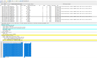

  • This is the nRF sniffer output while peripheral device was streaming to the tablet device
    (The Connection Interval is set to 10msec and DLE is ON). The 244-bytes packet is transfered in 150usec and then the connection is idle for the remaining part of the interval...
    So the issue remains how do I include more BLE packets in one connection interval instead of one(current)?
    What am I doing wrong and the speed is
  • The slave sets the MD(MoreData) bit to 1 when it sends the first packet, so it has more data to send. The master continues the connection event by sending a new empty packet, but the slave is not sending the packet in reply to that, and the connection event ends. In a 1-to-1 connection setup, I would have expected the slave to send another packet.
    Is the peripheral connected to several master devices when you tested this ?
    No the peripheral is connected to a single central device (tablet). The tablet app is configured such a way that it can connect up to 5 peripherals. The good thing is that the speed is increasedto 50kBps by changing  the GAP_EVENT_LENGTH from 5 to 10. Further increments did not increase the speed.
