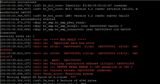

    Following is what happens on the Peripheral side:

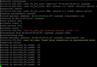

    And the Centrals side:
    It fails when trying to deal with this custom service I've made. This works when no encryption is enforced, however I've now set it to:

    and the Peripheral breaks down after fulfilling connected():
    static void connected(struct bt_conn *conn, uint8_t err)
    if (err) {
    printk("Connection failed (err 0x%02x)\n", err);
    } else {
    printk("Connected\n");
    int sec = bt_conn_get_security(conn);
    printk("security level is: %d\n", sec); //sec = 1 upon connection
    To answer your other question, passkey_confirm() doesnt get invoked on the Central either. Just let me know if you'd want me to paste the complete code, I'd just have to rename some variables like I did in the service register function Slight smile
  • There is an error on the peripheral side here, so we need to solve that crash first. Can you start by finding which file/line causes problems by using arm-none-eabi-addr2line -e <project_folder>/build/zephyr/zephyr.elf 0x51308 ? What code do you have on that line? Please share some code amount it as well to provide context, or even better your whole project.
