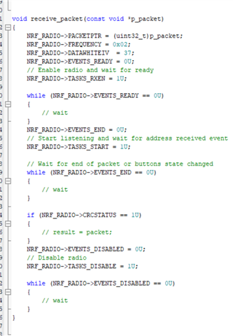

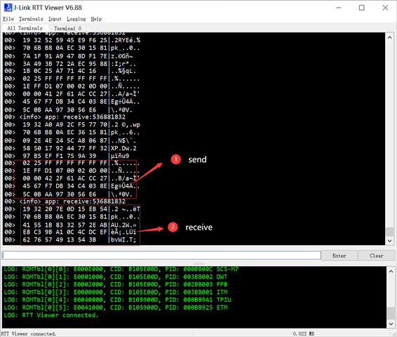

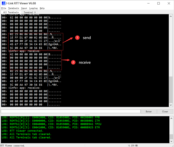

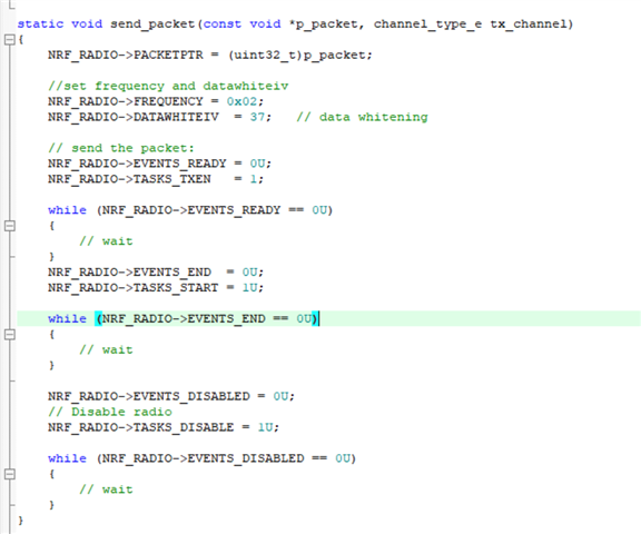

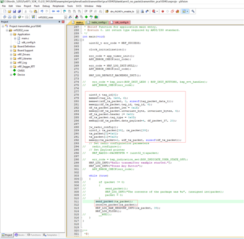

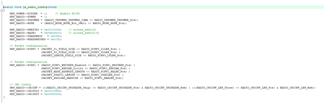

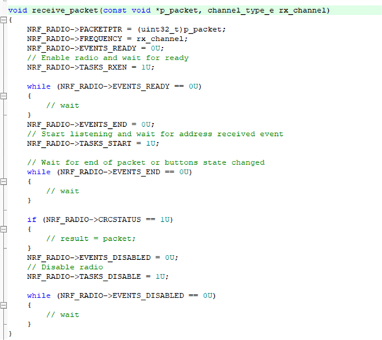

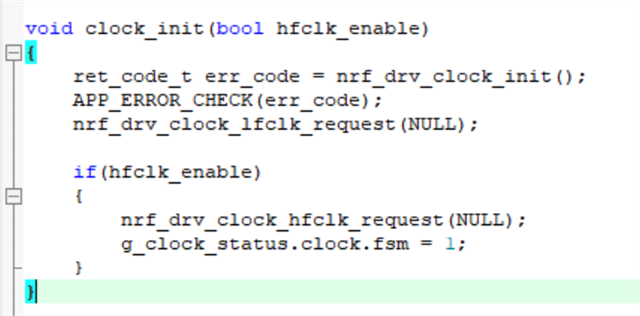

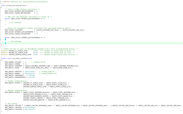

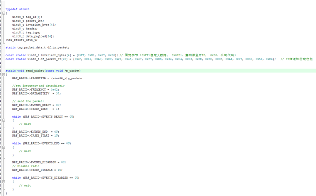

This one was written by a former colleague of mine, using radio to simulate a BLE broadcast driver.I use in my own project, it is completely possible to realize the radio simulation BLE broadcast data sending and receiving BLE broadcast data through this function.However, I ported these functions to SDK15.2 in the radio case, but found that they did not work, and the radio ported to 17.0 also did not work.At this time, there is a question. The configuration, sending and receiving of radio here are all directly operated registers, so there should be no problem of not being able to use the transplant.Therefore, I would like to ask whether there is something wrong with the related functions of radio in my side, which leads to the failure of using it during transplantation. In other words, the use of radio requires not only these functions, but also other aspects. Please kindly give me your advice.
