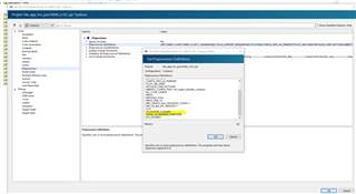

I have built the example hrs_uart project and it works fine when I load the image into a pair of OCA10040 demo boards, one as application board and the other as connectivity board.
I am trying to modify the UART/serial emulation project to run in the same way.
I copied the hrs_uart folder to the UART/serial folder.  in the sdk_config.h file I enabled the nus service and disabled the hrs services.
it was built OK. However, when I run it, It had a fatal error.
I debugged it and found that the function call nrfx_uarte_init returned with an error code 8.
please help on this issue

    We have not implemented macros to enable serialization. It's the inclusion of the serialization libraries and the globally defined 'SVCALL_AS_NORMAL_FUNCTION' flag in that makes a project a "serialization" project.
    An idea could be make multiple build configurations (like 'Debug' and 'Release') in case you want support serialization and no serialization within the Same segger project
