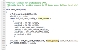

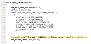

I'm trying to debug. I followed this video : https://www.youtube.com/watch?v=uP8RYgYGRvI&list=PLx_tBuQ_KSqGHmzdEL2GWEOeix-S5rgTV&index=7 .  But I can't completely.

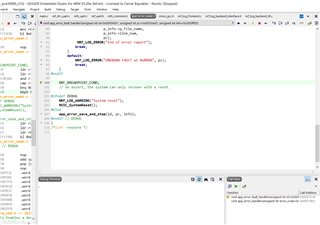

the program stop at NRF_BREAKPOINT_COND in app_error_weak.c.
I used breakpoint to understand which function the error occurred after.  I guess there is a problem when setting Uart. What should I do to better interpret the problem? What can be the problem ?
The program enters the following functions respectively:
1- nrf_drv_uart_init(...);
2- nrfx_uart_init(....);

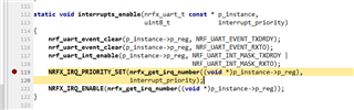

3- interrupts_enable(....)

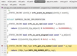

4- NRFX_IRQ_PRIORITY_SET(nrfx_get_irq_number((void *)p_instance->p_reg), interrupt_priority);
5- nrfx_get_irq_number(.....)

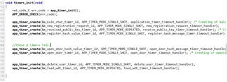

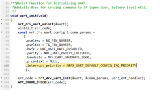

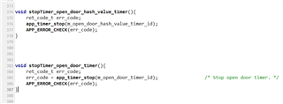

I added the 5 step's photos to explain better
1)
2)
3)
4)
5)

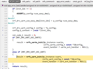

after step 5, the program stop at at NRF_BREAKPOINT_COND in app_error_weak.c
    Are you working on an example from the SDK? If so, which example is this?
    Are you using the RTT or UART logger backend?

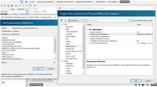

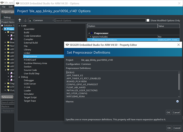

    Could you also confirm for me that you have DEBUG defined in your preprocessor defines, like shown in the included image?
    This will print a detailed error message to your logger output, if a non-NRF_SUCCESS error is passed to an APP_ERROR_CHECK.
    the current settings are like this, what should I do ?

    You are in the right place, but please change to display the 'common' configuration in the second window, like shown in my included image - you are currently looking at the 'Release' configuration, and as you can see it only inherits from the 'common' configuration.
    If DEBUG is not already defined in the 'common' configuration, please add it, like shown in the image from my previous comment.

  • If DEBUG is not already defined in the 'common' configuration, please add it, like shown in the image from my previous comment
    it doesn't defined in the 'common' configuration. I have just defined it.

    Yes, it is not defined there by default. Great! With this in place, you should see detailed error messages output to your logger backend.
