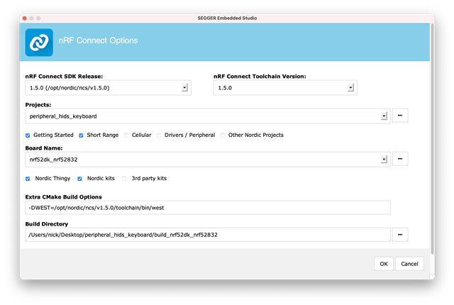

I'm trying to open a NCS project in SES but I'm getting error 1 from create_nordic_project.py. NCS 1.5.0 installed with toolchain manager on macOS 11.2.2
The error in SES log:

What I've tried:
rm -r ~/Library/Caches/zephyr
rm -r ~/.cmake/packages/Zephyr*
west zephyr-export
