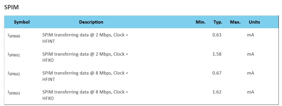

SPIM current on HFXO/HFINT
While digging for electrical information I came across :
.63ma using HFINT  or 1.58ma using HFXO ?

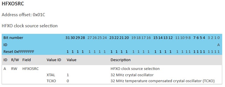

So I hunted down HFXO to see how to switch between them:
But nothing about selecting HFINT.
I found
The HFINT source will be used when HFCLK is requested and HFXO has not been started.
The HFXO is started by triggering the HFCLKSTART task and stopped using the HFCLKSTOP task. A HFCLKSTARTED event will be generated when the HFXO has started and its frequency is stable.
