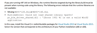

In the nordic documentation it says for errors but these are different. However to be sure they updated the VC 2013 lib
list of installed packages are attached.
Kindly advise what he is doing wrong.
