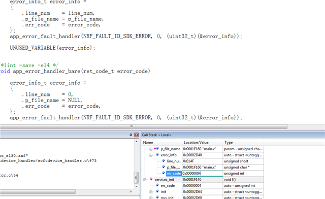

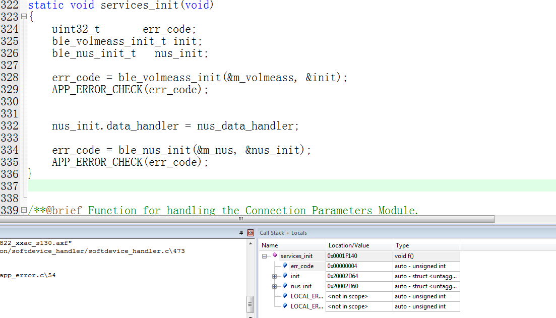

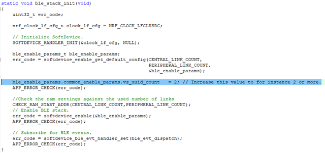

NRF51822 add new service ,can not search for  the  ble   ,when i close this service in the service init function  ,it will go back to the normal。
  • can not search for  the  ble
    What, exactly, do you mean by that?
    The searching is done by the Central - it is entirely independent of anything that you do in your peripheral.
    Did you also change something in the Central?
    Perhaps your Central is configured to only "see" certain specific advertisements - so your change means that your advertisements are no longer "seen" by it.
    Or (perhaps most likely?) your peripheral is just not advertising at all.
  • I also added the dispatch function,Does it really need to be set

  • So looking at your screenshot:
    This means that the error occurs in main.c, the error code is 0x04, which I can find from nrf_error.h is NRF_ERROR_NO_MEM, and the line number is 0x014F (=line 335 decimal).
    From you other screenshot it seems this is caused by ble_nus_init(). If you now can help tell me which nRF5 SDK you are using, then I can try to take a look into ble_nus_init() and speculate what may cause this. You may also set breakpoints yourself into ble_nus_init() to find this if you want to.
