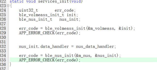

after NRF51822 add new service ,can not search for the ble

    uint32_t       err_code;
    ble_nus_init_t nus_init;
    ble_volmeass_init_t init;
//    this is the service i add
//    err_code = ble_volmeass_init(&m_volmeass, &init);
//	  APP_ERROR_CHECK(err_code);

NRF51822 add new service ,can not search for  the  ble   ,when i close this service in the service init function  ,it will go back to the normal。
  • So the error code ahs come from ble_nus_init().
    So step into that function, and see where that error code is generated.

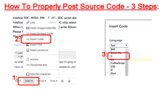

    not as an image, please.

  • So looking at your screenshot:
    This means that the error occurs in main.c, the error code is 0x04, which I can find from nrf_error.h is NRF_ERROR_NO_MEM, and the line number is 0x014F (=line 335 decimal).
    From you other screenshot it seems this is caused by ble_nus_init(). If you now can help tell me which nRF5 SDK you are using, then I can try to take a look into ble_nus_init() and speculate what may cause this. You may also set breakpoints yourself into ble_nus_init() to find this if you want to.
