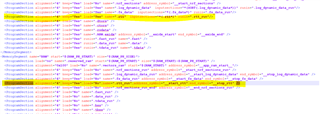

I have been using RTT viewer since a while and its works fine only if i program that board without DFU, and if i program this board with DFU it says "could not connect to target" as below...
and it disturbs my BLE Connection also, then i need to restart my board.
finally my problem is, i need to check(view/Debug) my data after DFU also, how can i do that please help me

    I'm using modified code of ble_app_uart example, Buttonless DFU, and secure_bootloader(ble).
    when i program my Custom board without bootloader(using j-link of DK board) the RTT viewer works fine, but when i program using DFU method(using bootloader) it wont work, i.e., when i try to connect in RTT viewer app the BLE disconnects and program stops working.

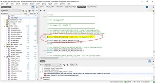

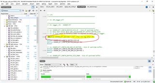

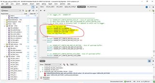

    Do you enable NRF_LOG_ENABLED and NRF_LOG_BACKEND_RTT_ENABLED in the sdk_config.h? You can refer to the sdk_config.h in the _debug project.

    --> Yes i Enabled NRF_LOG_ENABLED and NRF_LOG_BACKEND_RTT_ENABLED in sdk_config.h and i can see my LOG output in RTT viewer(j-link RTT viewer) when i program my board other than DFU(segger- Build and Run)
