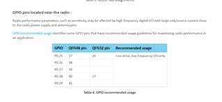

Starting new design using nRF52810 QFN-48. Can someone point me to the document that explains which pins on which package are advisable for I2C operation? I need to know all my options. Don't tell me, show me in a document. Document #, page # would be great. Thanks in advance.

    timl said:
    I realize that it depends on where I place my antenna, as to whether it disqualifies a pin as being too close. That said, what is the physical distance I need to keep high frequency GPIO pins away from the antenna?
    It's mostly dependent on the radio in the IC not the antenna. Which means that moving the antenna will not help, the pins should still not be used.
