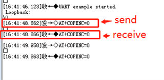

   I got trouble when I change “libuarte example”(nrf52840 DK, SDK17.0.2),the default example use RTC instance :
       NRF_LIBUARTE_ASYNC_DEFINE(libuarte, 0, 0, 0, NRF_LIBUARTE_PERIPHERAL_NOT_USED, 255, 3);
  and it works  correctly as following:

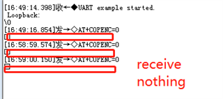

Then, I want to use TIMER instance, I did the following step:
Frist, NRF_LIBUARTE_ASYNC_DEFINE(libuarte, 0, 0, NRF_LIBUARTE_PERIPHERAL_NOT_USED, NRF_LIBUARTE_PERIPHERAL_NOT_USED, 255, 3);
 Second, I add app_timer_init() in main()
Then, I enable the sdk_config.h:
#ifndef APP_TIMER_ENABLED
#define APP_TIMER_ENABLED 1
#ifndef NRFX_TIMER_ENABLED
#define NRFX_TIMER_ENABLED 1
// <q> NRFX_TIMER0_ENABLED - Enable TIMER0 instance
#ifndef NRFX_TIMER0_ENABLED
#define NRFX_TIMER0_ENABLED 1
The above is all I did , but when I run the changed example, I can not receive anything, just as following picture:

  • Hi,Susheel:

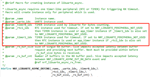

     Thanks your reply , the default instance is RTC0, but now I want use TIMER0,according to the Macro define:
    so I changed the define as below:
    I do according to your suggestion, But it doesn't work still, below is my mian.c now.
